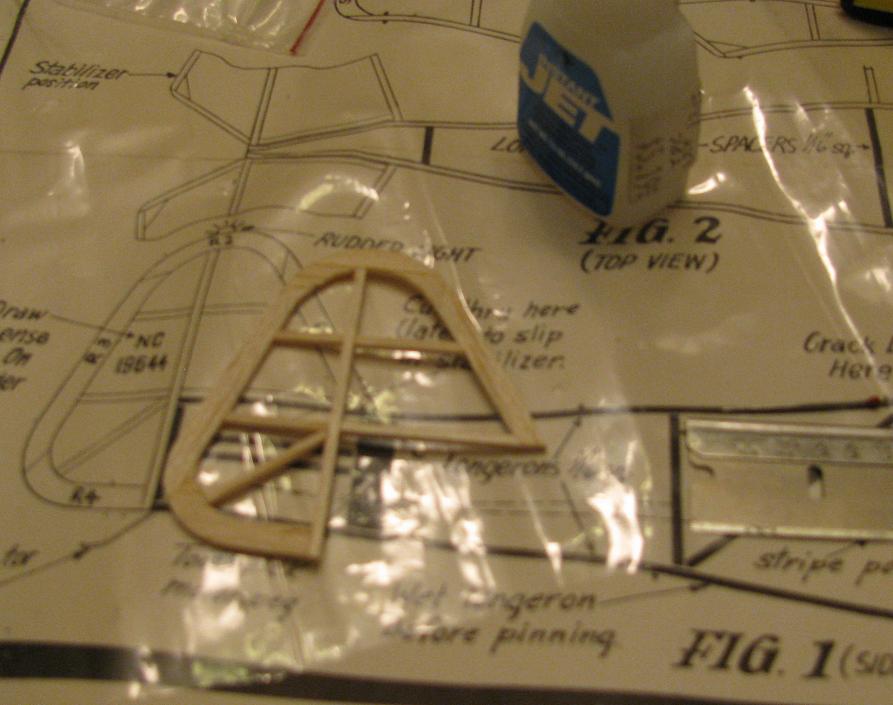

Wow, great to have SFA back online. I haven't touched a building board since Geneseo and this is just what I needed to sit back down and start building. But... what to build? I looked around for a while but nothing jumped out at me. So I decided to go back to the beginning. Back to the 1970's when I was just a kid watching the D.C. Maxecuters compete at a local contest. I was amazed and spent the entire day following them around watching them fly. At the end of the contest I was "awarded" a kit for being the best spectator. I promptly went home and built it and took it back to the field the next weekend. hideous plane that nobody could get to fly, and they tried! The kit was the Hi Flier Taylorcraft and I've never built it again. I've built a few other Hi Flier kits (loved the Howard DGA) and really enjoyed them. I picked up a bunch of Hi Flier kits recently, the Taylorcraft being one of them. I plan on building it right off the plan, no modifications (well, hardly any), and looking just like the box art. I'm not in a hurry so it may take a month or so but I'll try to work on it every day, even if it's only putting down one stick a day. Today I built the rudder, right off the plan. Mike

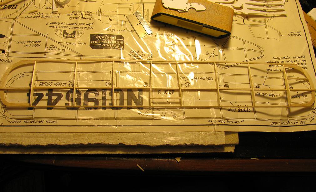

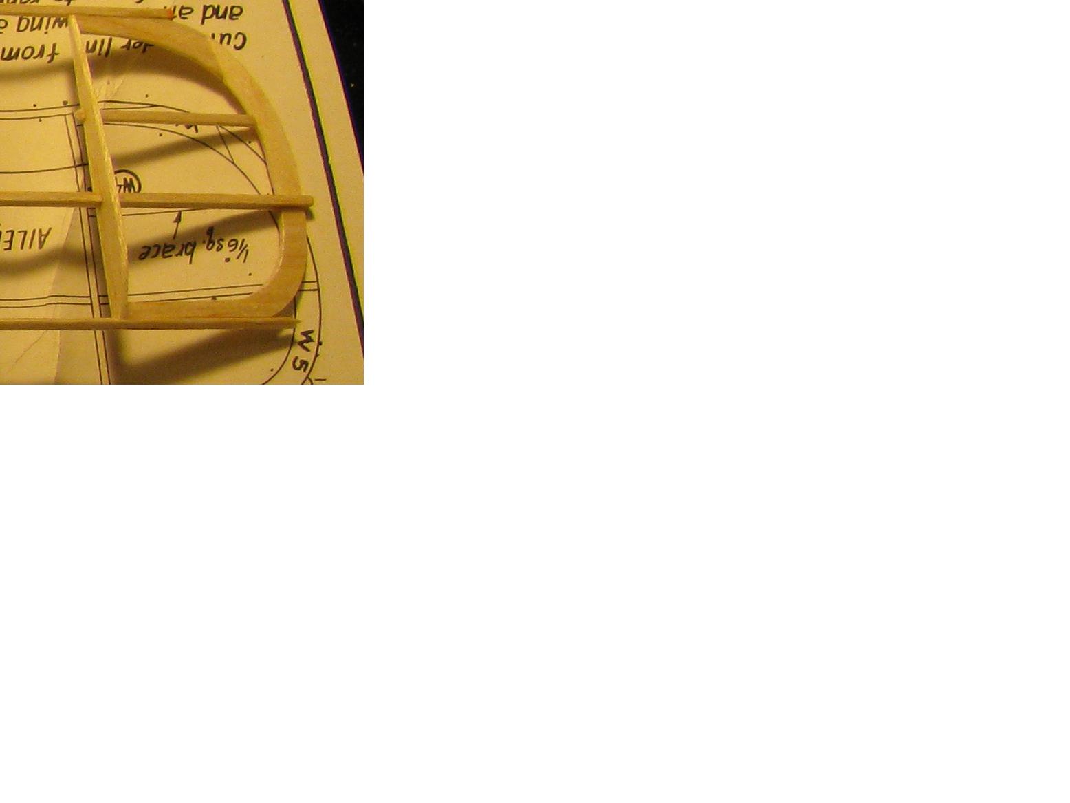

I built the wing to the Taylorcraft today. Nothing changed from the plan. If I were to change anything it would be the front wingtip piece. There's about an inch where the grain is going the completely wrong direction. I'll put in the dihedral and two little curved pieces after sanding. Tomorrow, starting on the fuselage! Mike

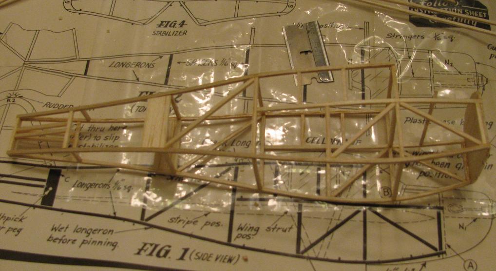

Here we go, fuselage mostly boxed up. I will be adding some landing gear wire as well as a balsa brace going up aprox 1/3 of the way into the fuselage. I haven't decided if I'm going to paint the fuselage before I cover it. It's not painted on the box art but it's something little that can make a big difference. I'm also going to make the styrene nose removable. I know that I'm losing some nose length but I'm not looking to get great flights out of this. Sixty seconds would be more than enough for me.

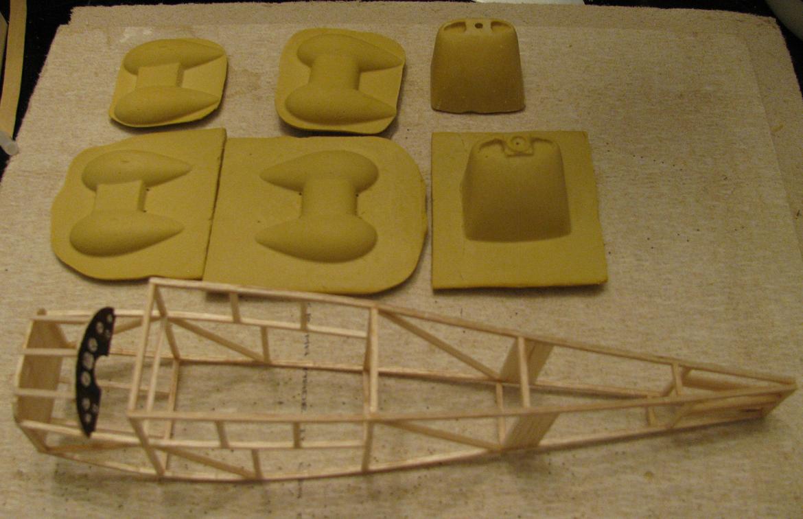

I didn't do much on the Taylorcraft yesterday and today. I added a few stringers and the instrument panel to the front. Mostly I worked on the plastic parts. Originally I was going to build the kit, that's why I built right off the plan. Believe me, it wasn't easy sticking a pin in the original plan. But, I wasn't using the original wood and the tissue is the wrong color for the box art so I started thinking of maybe saving the kit after all. I ended up making molds of the styrene parts. I wiped the inside of the styrene with vaseline and used Durham's Rock Hard Water Putty. I wasn't happy with the first set so I made a second set. One of these will work.

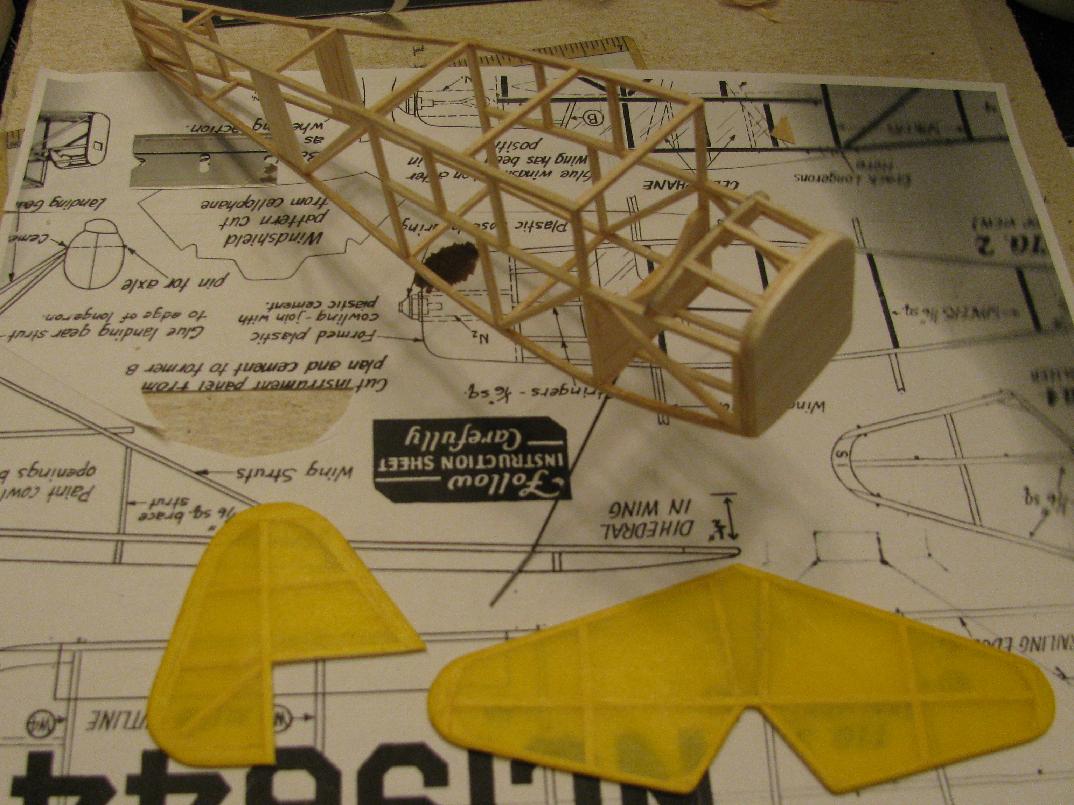

I started covering! I also put in the landing gear wire and made a noseplug to fit the styrene parts. I still haven't pulled the styrene but hope to do that this week. I haven't tried putting on the wing registration before I cover but I'm considering it. I've alway's put them on after covering and usually have pretty good luck doing it that way, but I can see the advantages of the other way. We'll see how I feel tomorrow.

Nice pace and nice build. If you keep this building speed, you can fly it at the weekend;-)
Lookg great so far.
