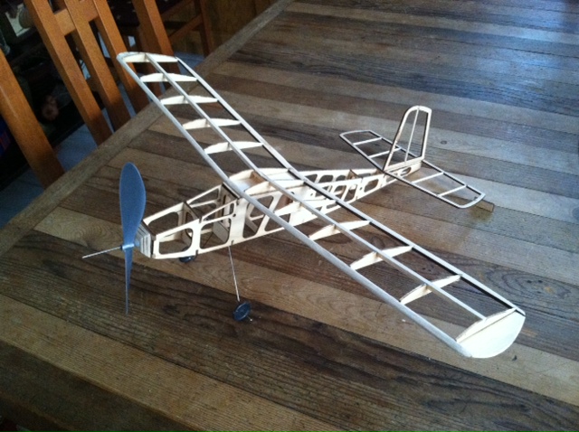

Some of the members (a few in their 90s) complained that they were beginning to have difficulty building frames with 1/16" square stock. Since I manufacture my own kits and have a laser cutter I decided to design a model with sheet sides, a heavier wing structure, with laminated formers and tail group outlines that could be built more easily, by someone loosing the feeling in their fingertips, while still being a good flier. My intent was to kit some up for the members who wanted to enter. I announced it and showed the prototype at the meeting last Wednesday and, so far, I'm producing a dozen. This model, the OD-17 (One Design 2017) should be an easy and satisfying project for a beginner. I'll be sending a few to selected modelers to get feedback as to whether or not I should make it into a regular production kit.
The photo is the first prototype stuck together for a "bones shot".
I discovered a couple of weak spots in the fuselage that make the building a little touchy so it has been redesigned slightly but the changes from the one in the photo are slight.

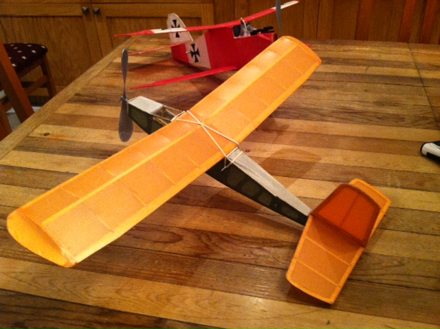

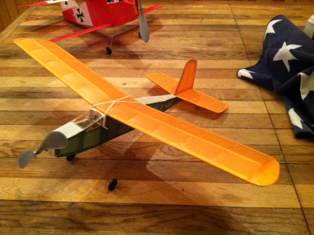

Here are a couple more views with the skin on. Flew it outdoors this evening and it flies better than I hoped. Indoors is another issue. Had to reduce the incidence in the wing to kill the rate of climb and there are some interesting trim issues for such a conventional design. The flying session ended early today due to the air conditioning being on full (Hot day!) so I didn't get it sorted out or get videos. I will try to get videos at the Luther session on Friday evening.

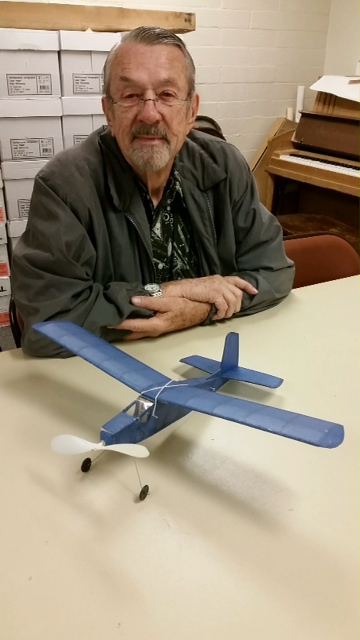

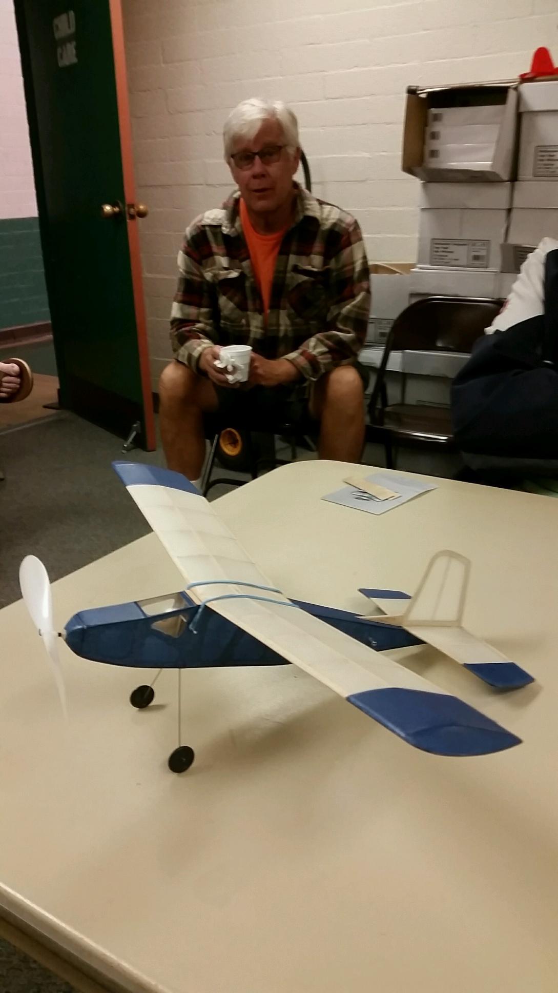

Some of the kits provided to the O.F.F.C. members who will participate in the One Design contest at the end of this month have been built. All the kits were provided with a sheet of blue tissue and a sheet of white tissue.
