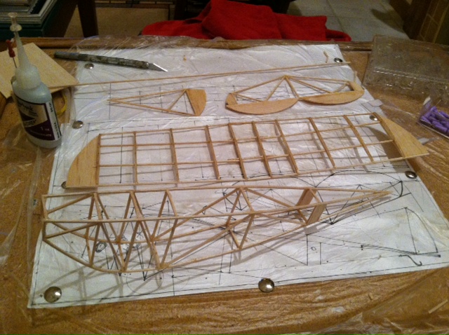

I didn't build it that year, but Legal Eagle came around in the contest schedule two years back and I started working on it. After all, how long can it take to build one of these things? I got the wings and tail feathers built and started on the fuselage. I built one side fine, but kept breaking the other side. When I finally got the other side built I broke it trying to assemble the fuselage. Something else came up and I didn't finish it.
Well, Legal Eagle came up in the schedule again for the 28th of this month. Now I have lots to do, like the production prototype and plans editing for the Wright Amount of Wrong, and making sure that the back splash tile is finished behind our new quartz kitchen counters before Christmas, but since my wife and a friend were doing some holiday baking this evening I took the time to drag out the box with the Legal Eagle bits in it to try again.

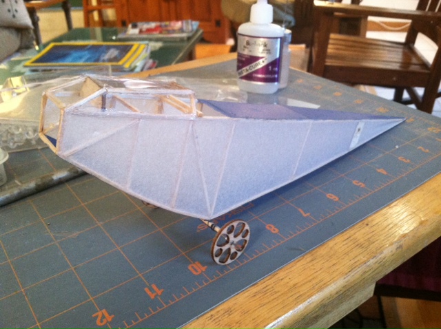

This time I used some leftover alignment jigs from my Bostillation development to make sure the second side of the fuselage is identical to the first one and used them to assemble the fuselage square. I had the fuselage finished, except for the nose block and the deck, in about an hour and a half, all while keeping up the conversation with my wife and her BFF and giving critical appraisal of the holiday goodies.
Anyway, here's a photo of it on the bench (TV tray). You can tell it's one of my older designs because of the excess truss work in the fuselage. My intention, gift wrapping and other issues permitting, is to finish it in time to test fly it at Wednesday's O.F.F.C. meeting. Let you know if it's any good.

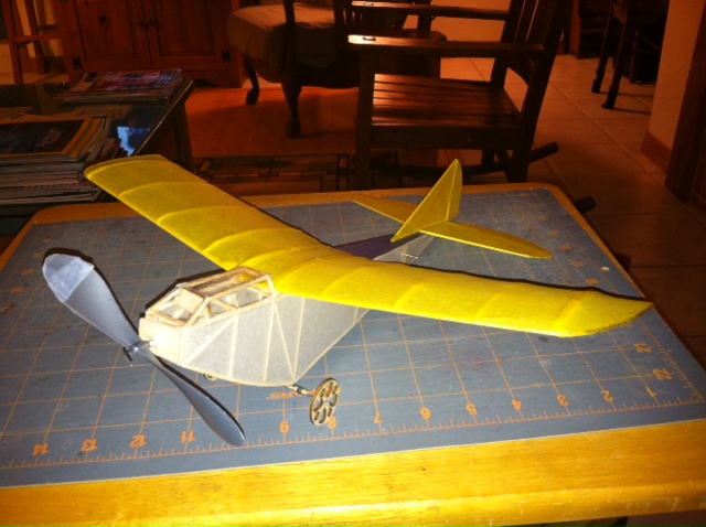

This morning I got it finished enough to test fly. (Still needs the windshield and head rest.)
It flew right off the board with no trimming necessary except for a small drag tab to get the turn tight enough for the room. It would fly nicely, hand launched, on 1/16" rubber, but would not ROG. Moving up to 3/32" rubber got it off the ground nicely but it flies way too fast to be competitive. A bit of fiddling around with propellers and rubber and I will probably get longer flights out of it but it will still be an also ran. It can be a lot lighter (12 grams without rubber now.) and I want to change the airfoil. Back to the drawing board!

I'm not familiar with the Legal Eagle rules, but I also see a few spots where some weight might be spared. How tight did you twist the 1/16th? If you have a rubber stripper, 0.075 might be a usable size. Is the plastic prop mandatory for the class?
A sweet looking plane that flies nicely!
Re: One Night In Jail
Actually, Legal Eagle is one of the more challenging events to fly. They are simple rubber powered models, but the rules are different from any other class:staubkorb wrote:I'm not familiar with the Legal Eagle rules, but I also see a few spots where some weight might be spared. How tight did you twist the 1/16th? If you have a rubber stripper, 0.075 might be a usable size. Is the plastic prop mandatory for the class?

Take a piece of American standard, legal paper (8-1/2 inches by 14 inches) and try drawing one. You get some really cute, and sometimes bizarre, designs. The 1/16 inch wood and the imaginary box limit create a built in weight penalty. Plastic props are not required but I used it instead of ballast to balance the model.
I will fly it in the contest, with a wood prop of the same weight with larger diameter and higher pitch. If I build another one I will have much lighter wing tips and elevator and rudder outlines. There are several good plans on the Internet if you want to try one.

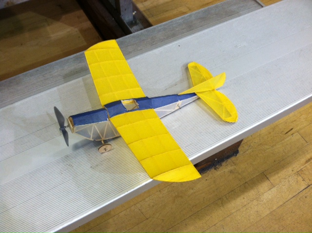

I added the windscreen and headrest, and went to a larger prop that weighed the same as the 5" Peck prop that I used for my first tests. Boy, did that mess up the trim! I could barely get it to fly. That's what I get for not having time to test it again before the contest. I managed to get some official flights in but the longest was about 30 seconds.
I did say, "Back to the drawing board!"
Looking at my 2017 O.F.F.C. calendar, I see that Legal Eagle doesn't come up again until June, so that gives me a while. I'm not giving up on this basic design since it's cute, different, and has shown some potential. (Even if one of the other contestants asked, "Why are you flying that ugly little airplane?")
I will leave out the excess truss work in the fuselage and greatly lighten the wing tips and tail outlines. If I can fit it on the drawing I will make the tail taller to compensate for the large side area at the front of the fuselage. The cockpit will be moved off the wing, making the structure simpler and lighter and eliminating some aerodynamic problems that I think I created by putting the cockpit where it is. Of course, the biggest change will be single covering the wing. There's nothing wrong with the lift provided by that wing but it needs the drag to slow it down.

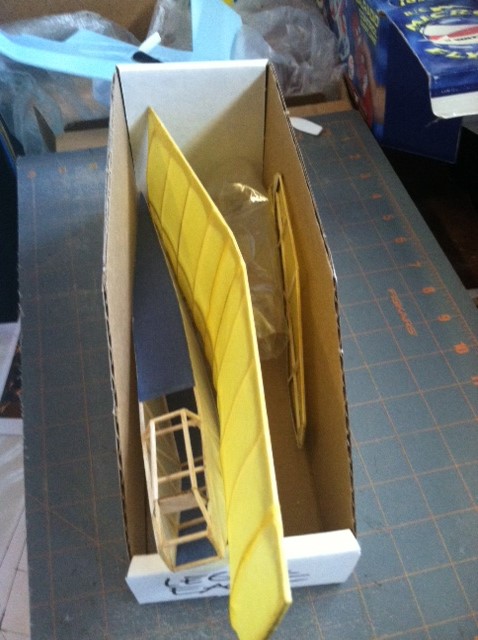

Anyway, I did get back to the parts in the box this weekend.
I said the I would take the cockpit off the wing to improve the aerodynamics and I did. How I did it may look a bit weird
however, it does satisfy the rules. Somehow, the fuselage did not look so alarmingly lizard like in the drawing.
It all came together smoothly ( chipped nose block not withstanding) and, by way of celebration, I treated my wife and myself to a home made root beer float.
At the O.F.F.C. meeting, this morning, the opinion of it was that it was so ugly it was cute. It took a little trimming and adjusting of rubber size but it's flying characteristics are stable and slow. (No ballast again! Still can't believe I'm that good.
) Should be competitive with a longer motor and a re-pitched prop. Videos next week.
