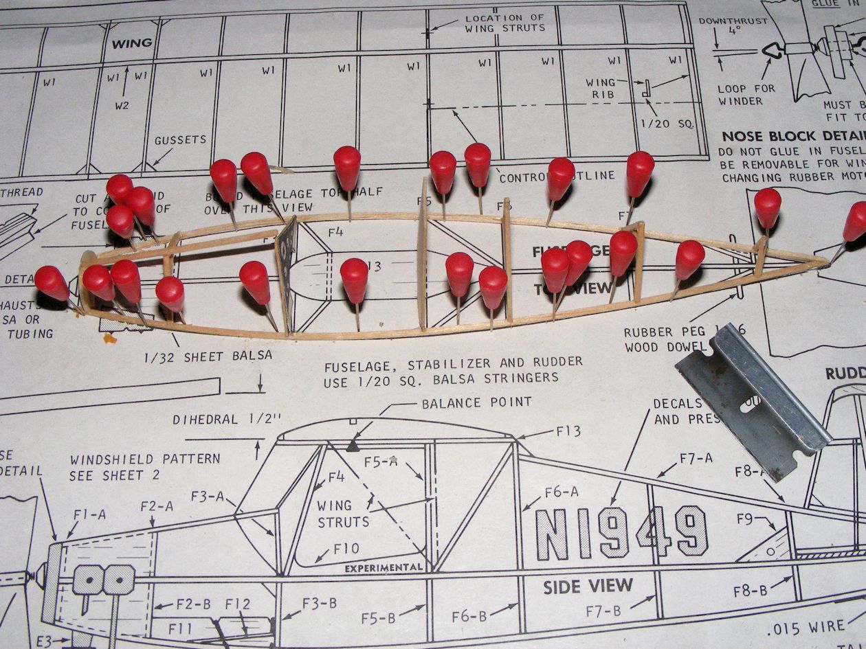

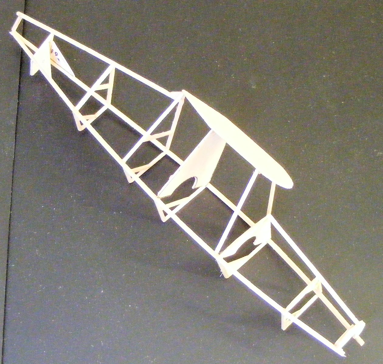

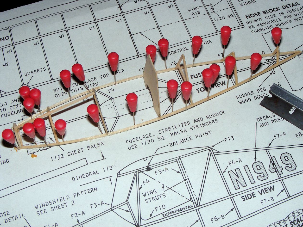

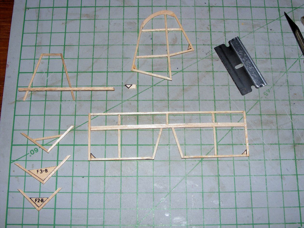

A few photos of what I have accomplished during the virtual "reality" junk on the tube (Am. Football is reserved for watching
Having to build the "formers" is a new twist for me, and the 1/20th (1.2mm) sticks plus the 0.0276" (0.7mm) former gussets make everything very interesting...
- DSCF6396_s.jpg (229.99 KiB) Viewed 36958 times
- DSCF6395_s.jpg (281.22 KiB) Viewed 36958 times
- DSCF6394_s.jpg (275.5 KiB) Viewed 36958 times

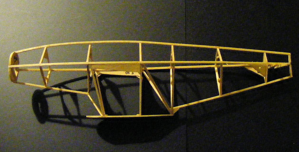

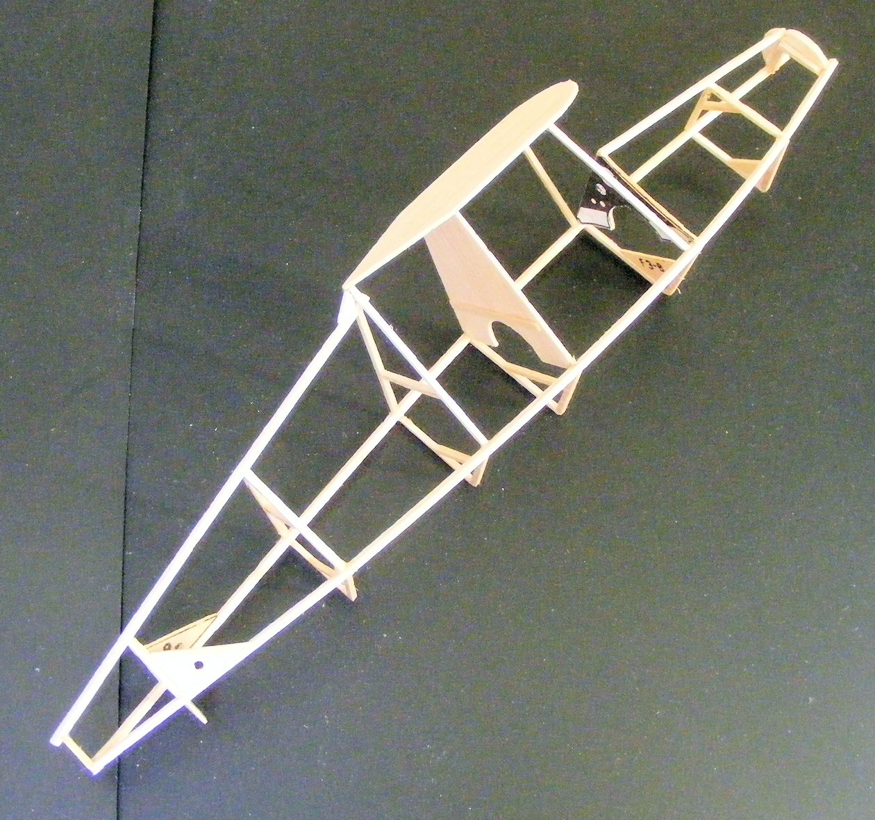

I gotten the fuselage nearly done - construction-wise. Only needs the nose sheeting and the landing gear gubbins (bend the wire and add the locating braces. Starting to cut out the ribs. Todays photos show the fuselage as of 7AM minus the bottom keel and the cabin braces/framing - weighs 0.680 gms. The weight crept up to 0.888 grams with all the work from today and will probably hit 1 gram once it's ready to cover
My RIVETS fuselage was a snap compared to this beastie!
- DSCF6398_s.jpg (317.35 KiB) Viewed 36893 times
- DSCF6397_s.jpg (309.19 KiB) Viewed 36893 times

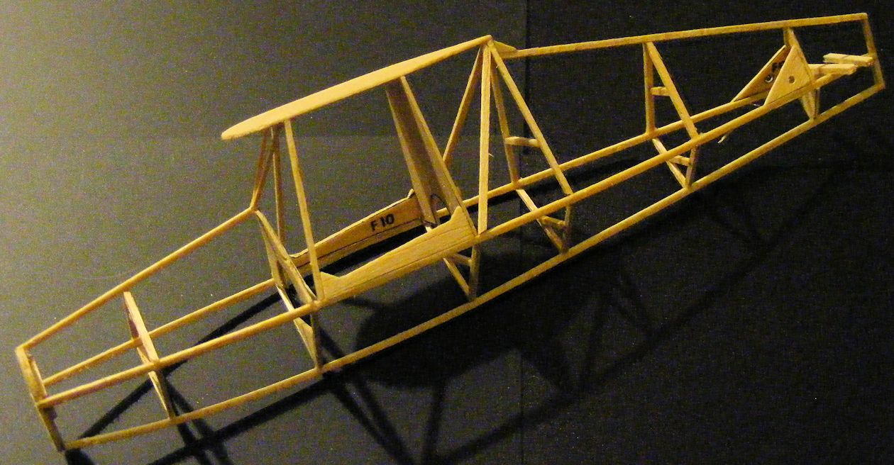

The fuselage now. Wing ribs are cut out and trued.
- Weight: 0.888 grams
- DSCF6401_s.jpg (163.81 KiB) Viewed 36867 times
- DSCF6400_s.jpg (172.9 KiB) Viewed 36867 times
