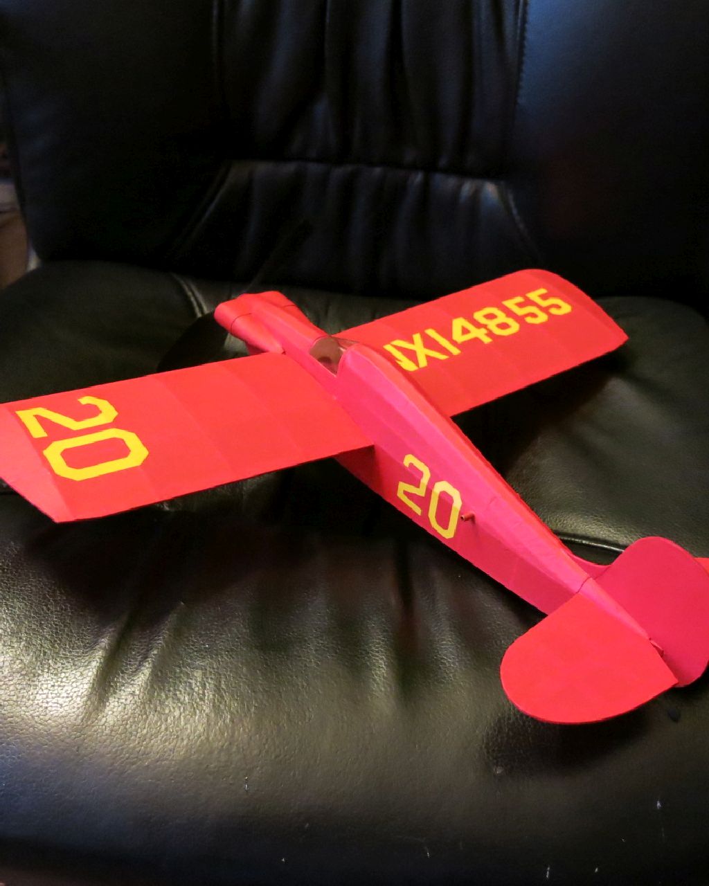

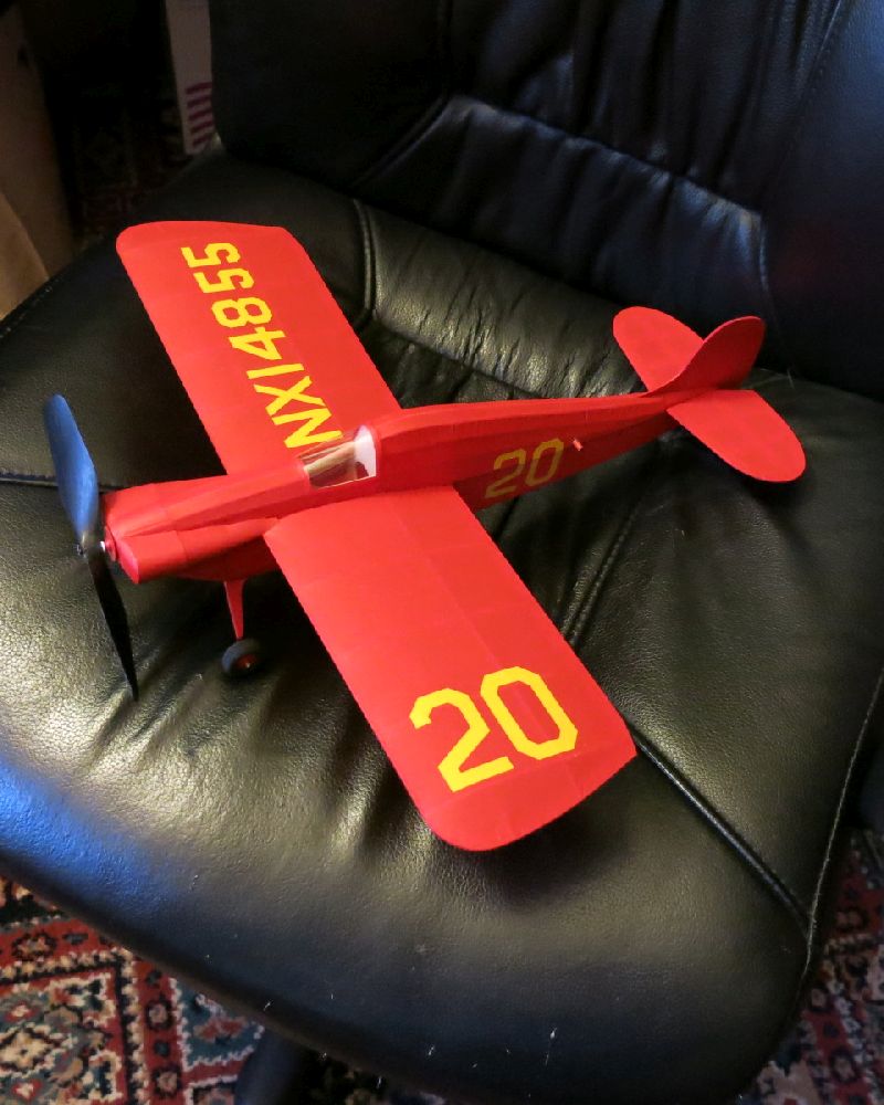

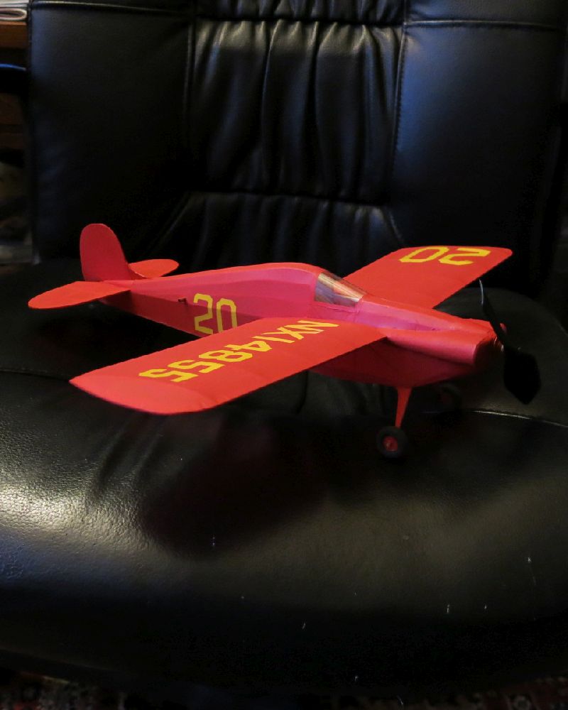

This is something I started years ago and have at last got to the finishing stage. A Veron, Steve Wittman "Buster". I started it as a possible kitscale entry but I couldn't live with the unpainted "red" esaki finish (nearer to pink in reality!).
A question for all you experts out there. I did the main lettering with painted decal paper (see Mike Stuarts website for how to do this beautifully). The tail reg, "Wittman special" and "Buster" lettering is far to small to do this way so I made some decals. A straight print of yellow on clear decal paper is useless; the yellow disappears completely. So I tried printing on white paper with a red background as shown in some of the photos, but they still look like banners on the model, the red doesn't blend in with the painted colour background. (the photos make them look better than they really are).
Does anyone know a better way?

I too would love a solution to the small yellow/white letters problem. I've sometimes tried to blend in the edges of the decal with the same paint as the background, or even to fill in the gaps between the letters with a fine brush, but it's not a very satisfactory answer. I usually print such decals in several subtly different shades too, and hope one is a better match than the others, but have never really cracked it.

The best way I've found to do lettering like that is to stencil it onto some masking tape, cut it out and then use that as a mask for some light coats of paint. Takes a bit of patience to make the stencil.
Or, depending on your printer, run the clear decal paper through with the lettering in a light orange colour, then overprint that with the yellow, it works with a laser printer, but not sure with an inkjet's transparent yellow. There is an element of luck involved getting it to print exactly over the previous print though.

Sorry for late reply - only just seen this topic. There is no easy solution to this that I can see. On a couple of models I have done what Pete suggested, and touch up between the letters with a fine brush in the same colour you sprayed, while the decal is still on the backing sheet. Then cut out as close to the yellow letters as you dare and apply. This works best for colours which stay the same shade even when you apply an extra layer of paint - e.g. my dark blue Fiat G.91. Red doesn't cover so well, so there is a chance your brushed on red will look darker than the sprayed red. Still should be closer than what you have though. This is one reason I tend to choose light coloured models with dark registrations!
