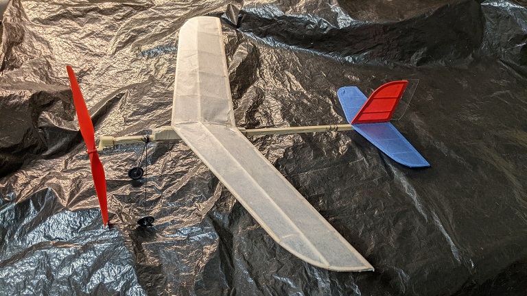

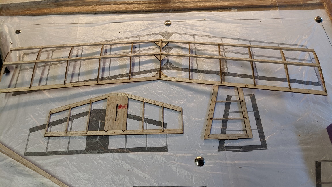

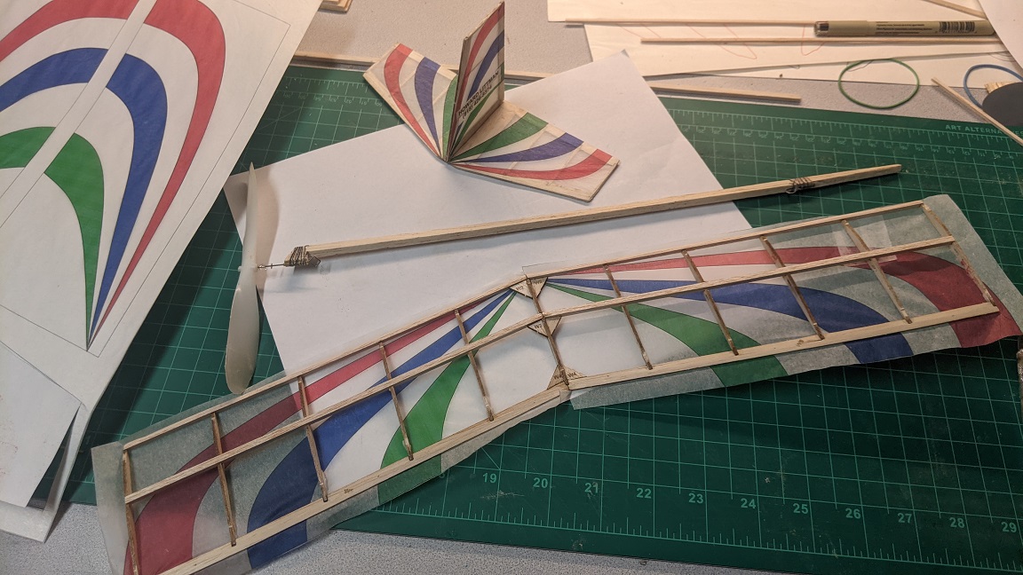

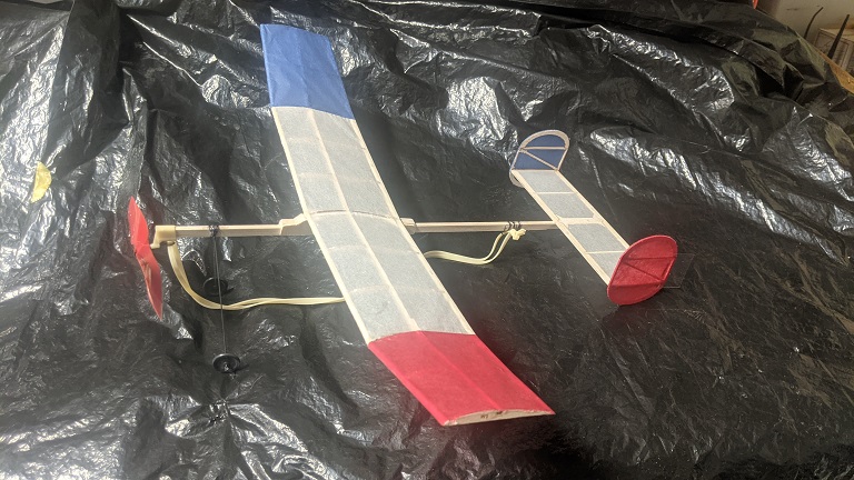

The working name of this model is 'Side Effect'. I designed and prototyped it this week to a special request. In "backyard testing" it seems to perform as well as the Sig Cub but is a bit smaller (18 inch span). It will get a thorough test tomorrow after I have done my official flights at the Sig Cub Flyoff Challenge. Possible production...More later.

It flies well (I treed it this morning, but I had my pole!) but I will make a few changes before production. (Of course I will!) There will be bit more dihedral (Just a bit, with swept wings you don't need as much.) and some components will be reduced in size along with a lighter prop with a stronger prop shaft. I think I can get 5 grams off of it. Look for it in the "Specials" section of my web site, along with a Dave Gee design "Climber", in about a month.

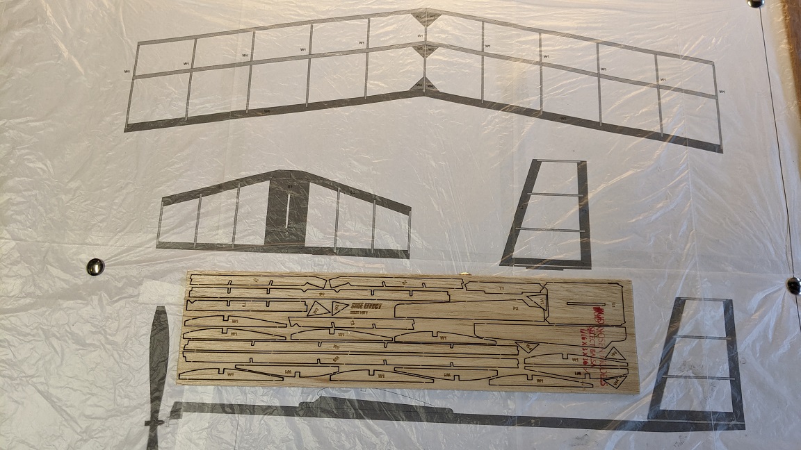

I've been checking the site for the Side Effect listing. Looks to be an easy build with the laser cut parts.
Re: Side Effect
Not quite finished with the development yet. Will be on my web site in December along with some other "postal contest" models in the works.

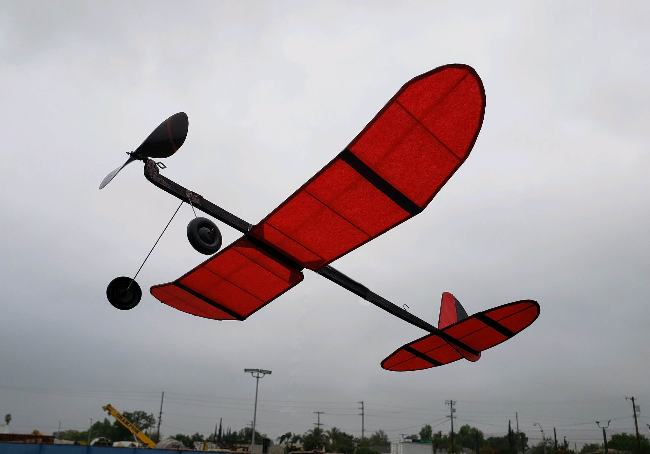

Here is another result of the discussion of new postal contest models that I had with Dave Gee. The working name of this is Meow.
The first flights were indoor at Stonehurst. Once I had established the turn for the room (53 feet wide) and found out how much rubber it needed to get near the ceiling (20 feet) but stay away from the lights it was giving consistent 40 second, ROG, flights with stability as if on rails. Outdoor testing this weekend at which time I will have the third design resulting from the discussion to test also. At least one of them and maybe all three will make it into kit.

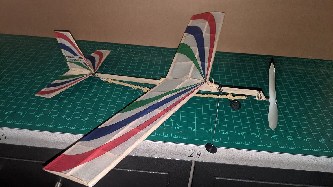

Here is the third design to come from the discussion between myself and Dave Gee. The working name of this one is Ascender but Dave thinks I should name it after something sharp. I've drawn a printed skins similar to the one that I did for the Side Effect. It flies as expected the only trim required was a slight increase in wing incidence.
Dave's design is called the Climber and is very much 1930's nostalgia.
All of these models have an 18" (45.72 cm) wing span. Now the problem is which one to release, or all of them?
