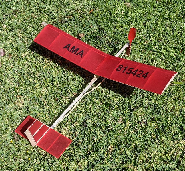

Threw together a Sig Cub for a contest on Sunday. The Black Sheep Exhibition Squadron challenged the South Bay Soaring Society to a Sig Cub flyoff. It's an old timey R.O.G. with a 24 inch wing span and a relatively quick build.
I did some back yard trimming this afternoon to prepare for the flyoff and discovered that it can be trimmed to a marvelous, floaty, glide and with a motor of two loops of 3/32" Tan, Sport rubber it will climb on 50 turns! The plans call for two loops of the 1/8" that comes with the kit, way too much power! I predict some OOS flights if the weather is good.
