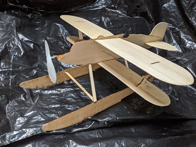

I decided to take a different approach and although I was very busy with my 1:16 scale prototypes managed to squeeze in a quick and dirty, all sheet, LoCal size Curtiss R3C made from balsa scrap in my shop. I decided on the floatplane version figuring that it would simply slide off the gym floor and that the floats would keep it in a level takeoff position. Boy, was I wrong! I had tested it by flying it free over tall grass and it flew. What I didn't realize is that the apparently glossy gym floor is really a non-skid surface. The model would not even move. I ended up making some small wheels and putting them at the bottom edge of the floats. At the next meeting I found that I could get it off the floor but it only flew about 10 mph.

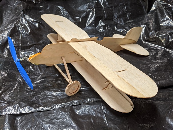

I decided to make a landplane version of it and try that. I won't know how well it works until the next meeting and there is a contest so I don't know how much testing will get done.

Well, I got to test the landplane version. It may be a model of what was once the fastest airplane in the world but it isn't fast. The best I could get out of it was 12.3 mph. As an RTP speed model it's a dead end.
It does fly free in completely dead air indoors. With just to prove the point I flew it the length of the gym, about 100 feet. Flying outdoors is only possible in the completely dead air of dawn and dusk. With no dihedral if it gets his by the slightest cross wind gust it flips over on its back. However, it is very cute and I may do a NoCal version or even a 1:16 scale version if I can squeeze in the time.
