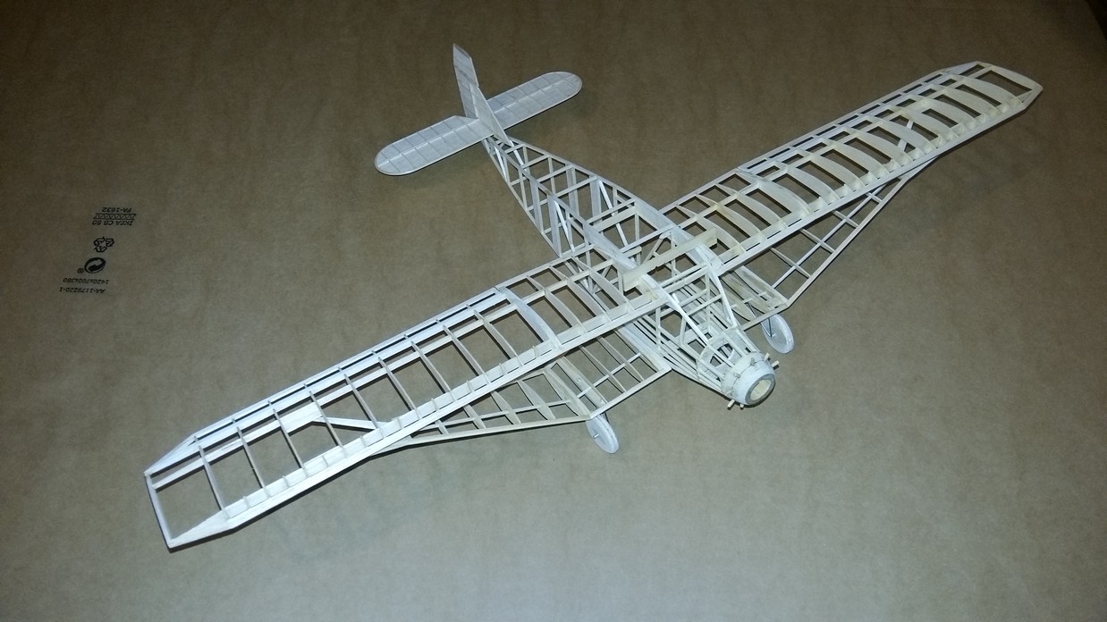

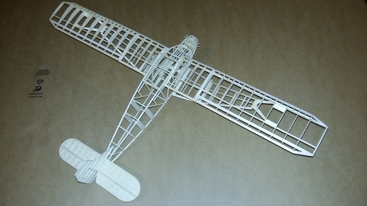

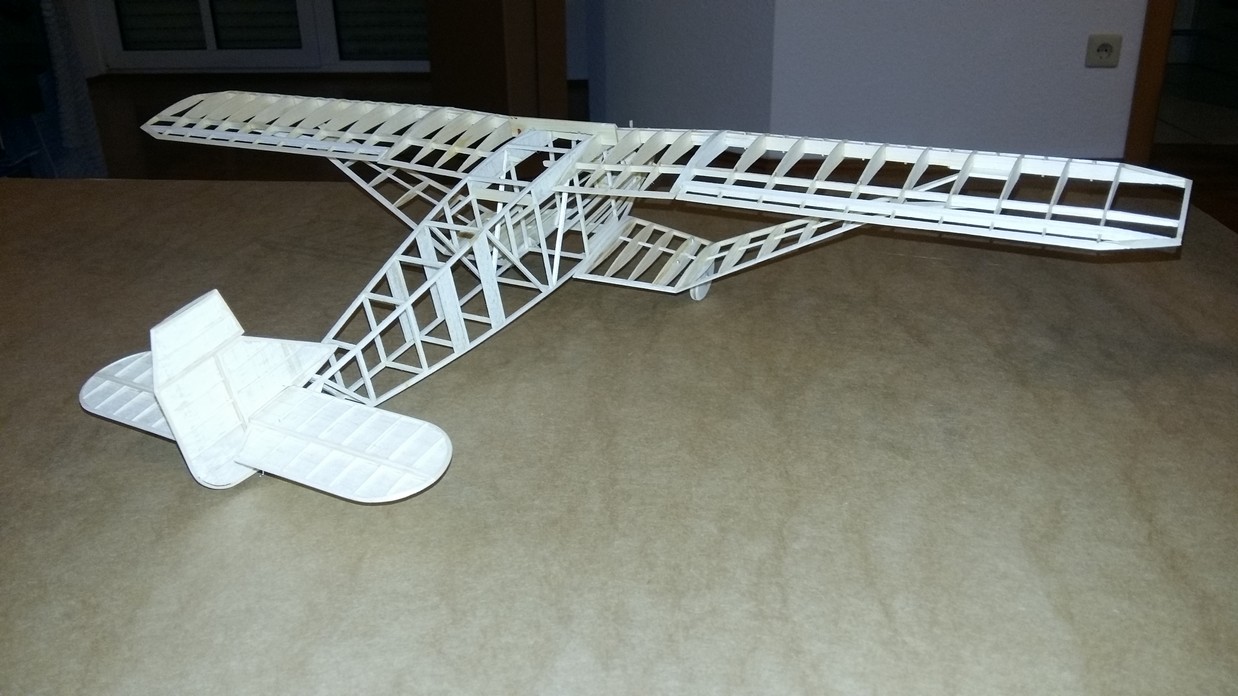

My current project is a rubber powered Bellanca "K" from 1928, nicknamed "Roma" as it was intented to fly from New York to Rome. The flight never materialised. The model has been a long time favourite of mine, but lack of adequate documentation meant a very long wait.
Eventually I managed to make the necessary drawings, based on many photographs and an original GA drawing, which appeared last year in Skyways magazine.
So, a model was started as well. Having had a rather bad experience with my Avro F, I decided to build a quick undetailed model first, as a test model for flying. In the future a better one will follow, hopefully.
The model in the pictures is 1/32 scale, with a wingspan of 620mm.

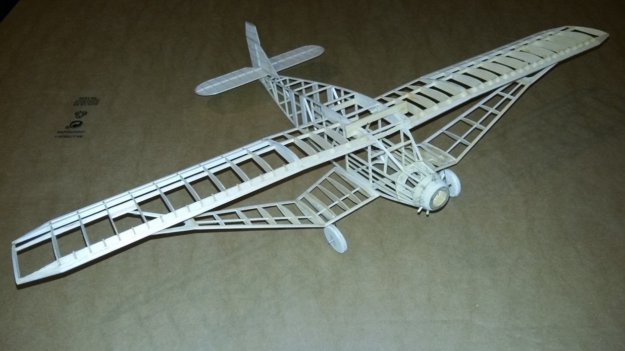

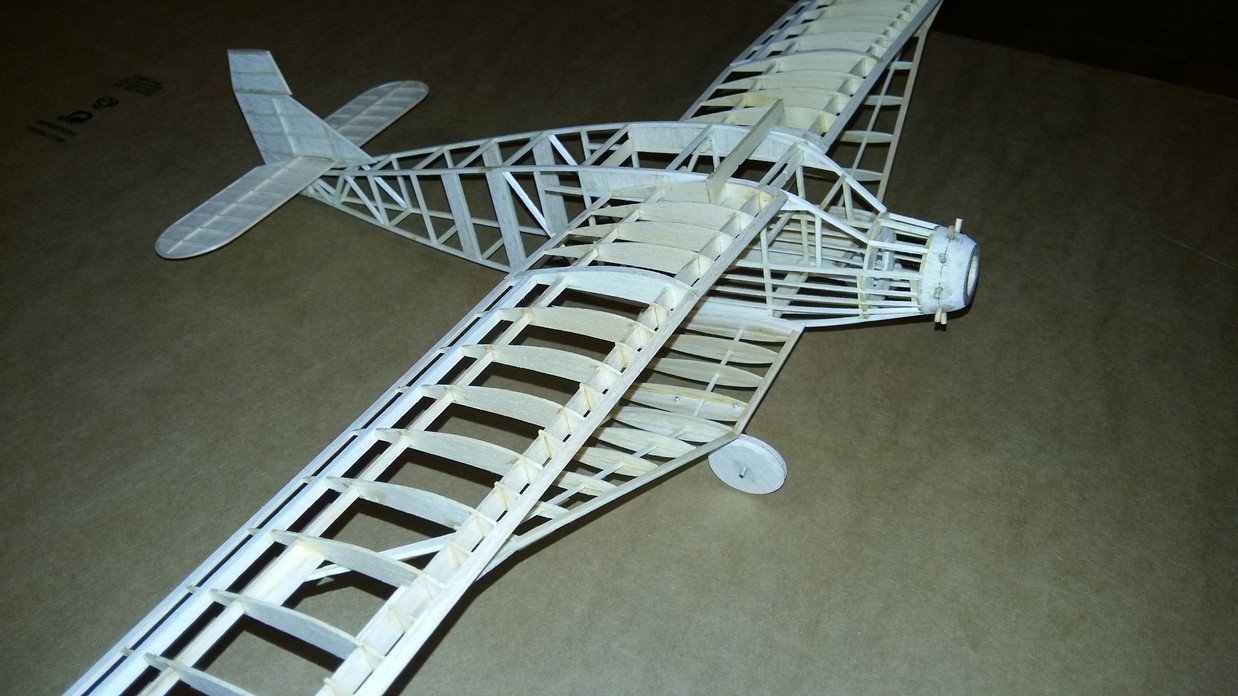

I do not know the file size limit for pictures, so here is a second message with three more...

George,
That's beautiful! I suspect that your "undetailed" model will still amaze us. The models you've posted in the past were works of art, I'm sure this one will be the same.
Mike

Great George
Do I understand it right, that you will build a second model with more details. Or you will add more details to the model once it flies nicely?

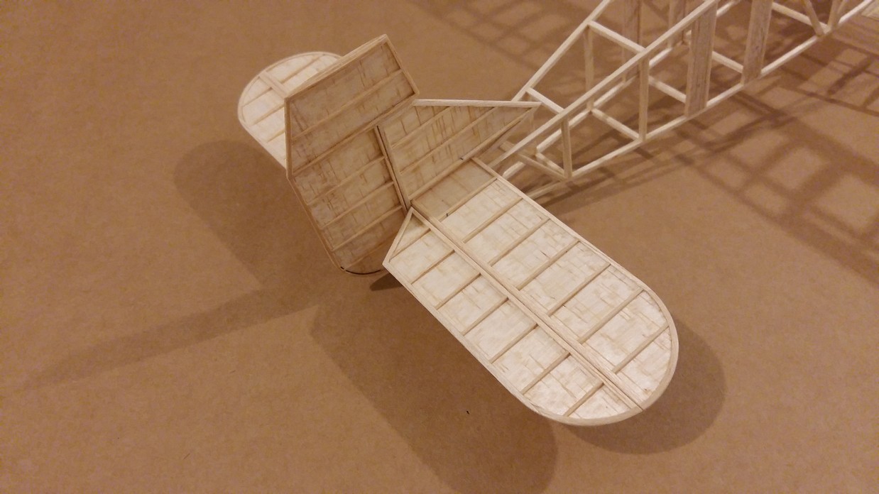

Whats the reason for the sheeting on the stab and rudder? Is it this way to prefent warping?

The intention is to build a second model once the flying setup has been defined.
What you see is a rather quick result without much attention to detail or weight.
As for the tail, it is my preferred method (copied after Bill Dennis Aeromodeller articles) for models with painted finish. It allows a rather warp free surface and very thin edges, which are more realistic in my view.

Looks nice George. I don't think I have ever seen the treatment you have given for the tail feathers. Thin surfaces and warp free when painting. Nice work.

Lovely set of bones George and an unusual looking aeroplane.
