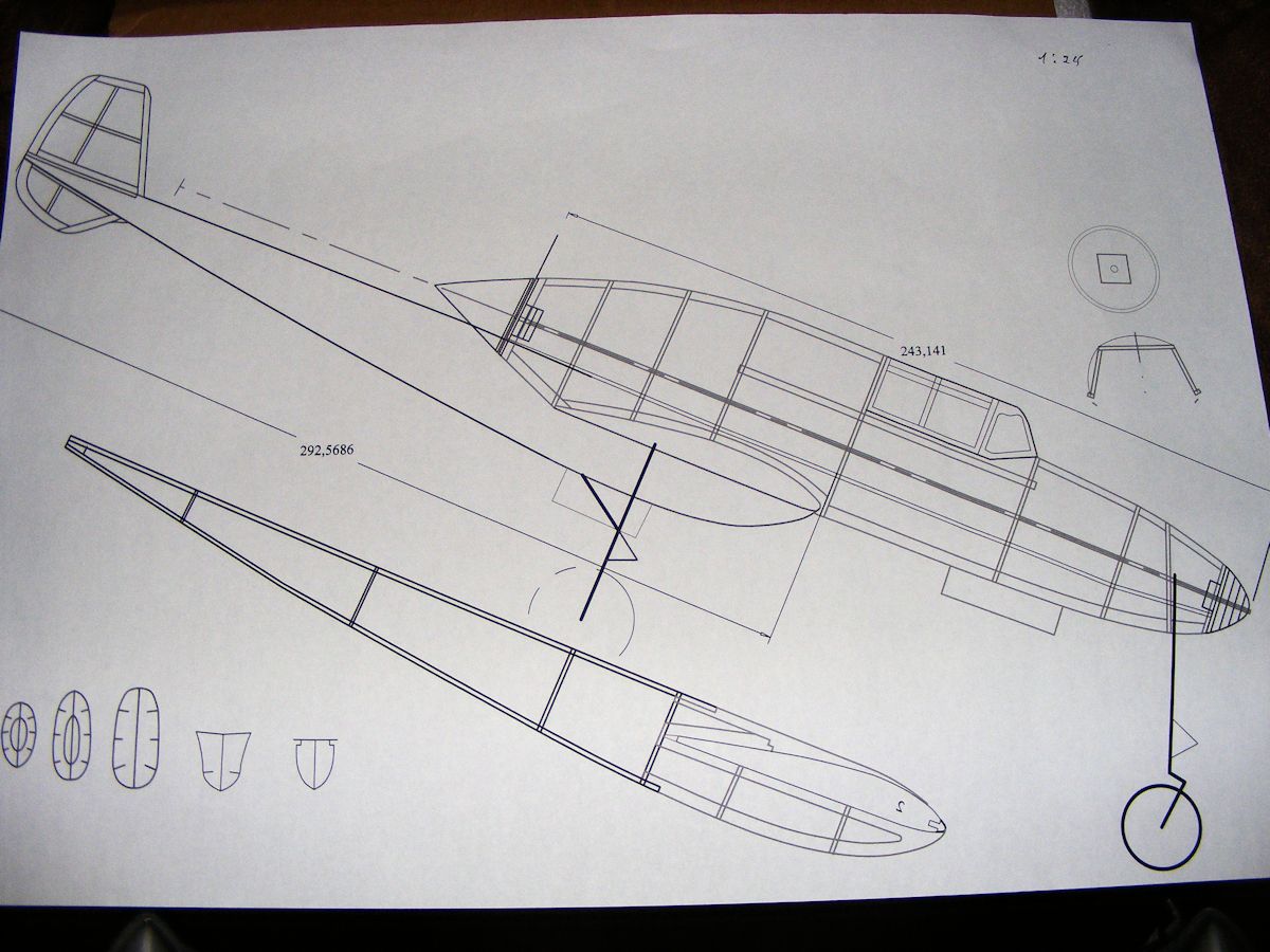

An aircraft that has long intrigued me is the SAAB J/A 21 pusher fighter that was further developed into Sweden's first jet fighter. I was aware that Pres Bruning had built a rubber powered version sometime around 2004 and wrote to him if a plan was available ( assumed it was his design). A few weeks later I received a letter with a tiled print of the hand drawn (sketched!) plan by none other than the late great Nate Sturman!
The scan was/is fair/good, but the penciled in notations were all but illegible and masked some critical areas of the drawing so I re-scanned and loaded the pages into my TurboCad 4 (!) and started to redraw and stitch the tiles together.
Fast forward to last month, I completed a rough drawing (going thru TC4, v8, then v12.5 and finally v21) to what I hope will work for a viable model. I'm presently cutting wood.

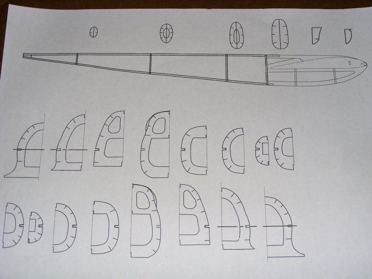

Here are photos of the prelim plan that I'm using to check the buildability of this puppy.

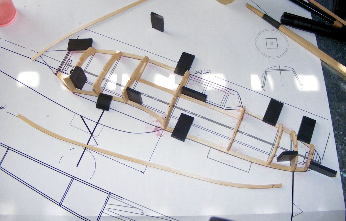

Started gluing up one of the booms and the fuselage to check parts fit and found a few areas that need adjustment - a couple of formers are a bit too short. Lot of work in this puppy, but otherwise is shaping up well. Pictures soon.

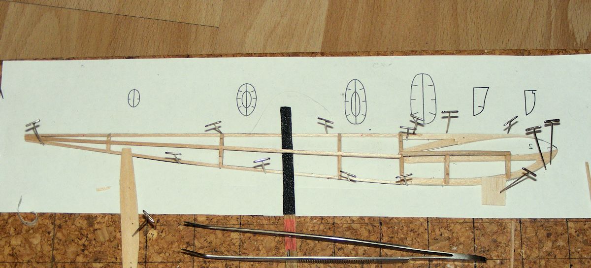

Slow work due to too many other projects, but here are two pics. The "issues" with fitting are more to do with poor cutting - on these smaller models, a half millimeter makes a BIG difference! The one fuselage former (F3) was traced from the original hand drawing and I neglected to check the dimensions with the fuselage side-view :oops: . The rest are within tolerance (but not for laser cutting - have to work on that...).

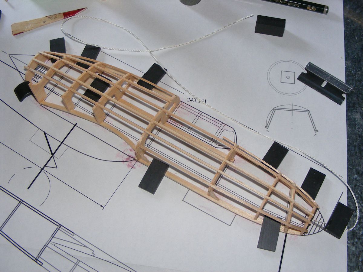

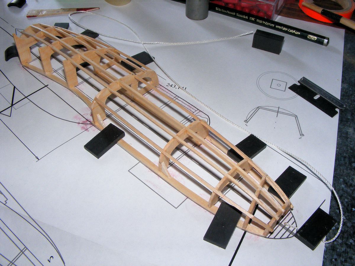

Slow going (as usual for me :| ), but cutting, test fitting, modifying and adjusting takes its toll.
A number of the stringer notches as drawn in the rough plan were off quite a bit plus the two height errors on formers 3 and 4. The only notches that I pre-cut were on the nose former (the others were simply marked) and I used the string plumb method to get the rest to line up. The string is visible in the photos.
Three stringers still need to be added - One on the upper rear and two lower forward.
