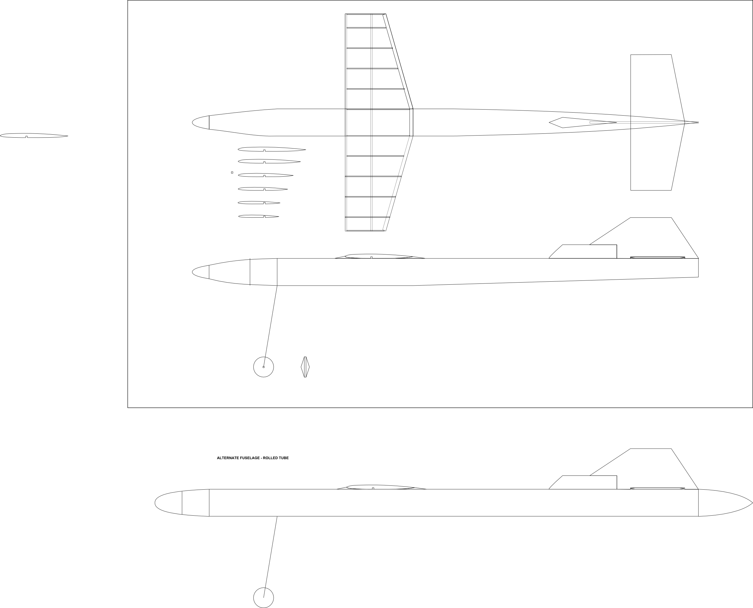

Here is the preliminary drawing for The Speed Merchant, my Round-The-Pole rubber powered speed model, for the contest at Duarte on February 16th. Before I cut wood I'm considering moving the wing to the bottom of the fuselage. the tether wire will go from the right side of the fuselage, embedded in bottom of the wing about half way between the leading edge and the spar, to the left wing tip where it will have a loop. Will test both two and four blade prop. If other obligations permit I will have both the built up fuselage and rolled tube versions ready for test flying at Duarte on January 19.

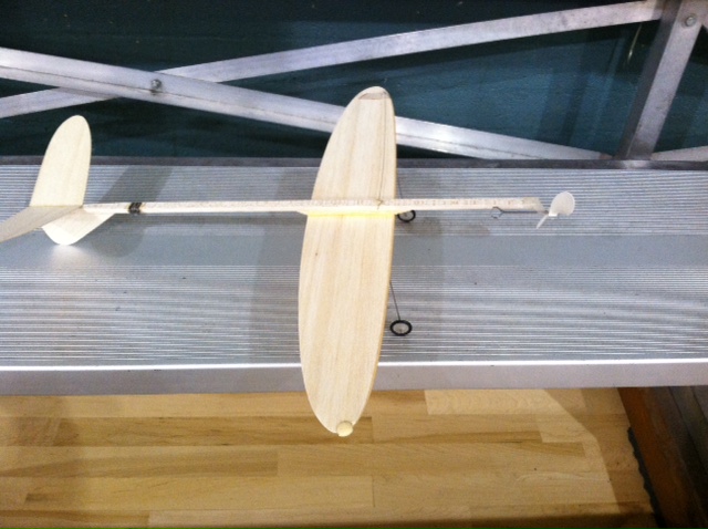

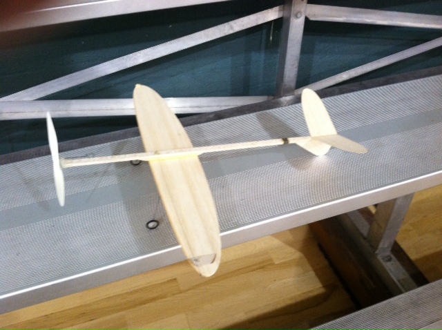

Jim Leuken brought his first interpretation of a rubber RTP speed model to the O.F.F.C. meeting this morning. It has some interesting features.
The rubber motor is on the outside side of the model instead of on the top or bottom to add a little tip weight. The wing has a higher aspect ratio than most of the designs I have seen, the landing gear attaches to the wing, not the fuselage and it has a Y tail with an under rudder.
Flight testing showed it still needs trim sorted out and the right combination of rubber (A lot of rubber!)and prop. More designs are showing up. Dave Gee showed a sketch of one he is working on that shows his usual penchant for bending the rules. Don't think that one will be built. More next week.

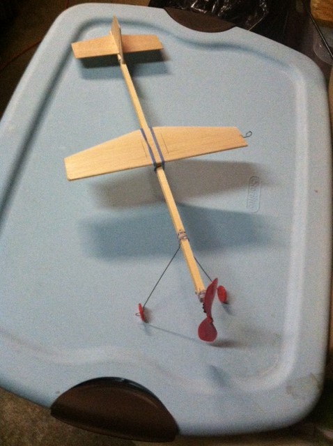

At yesterday's O.F.F.C. meeting we did more testing for the RTP speed event. I brought another test hack, an ROG type stick model with the wing and tail surfaces of my Speed Merchant design. Jim Leuken brought his improved design from last week and we had the three foot pole called for in the rules. Bill Watson brought the electronic timing pylon that he built for the contest.
My test hack had the wing held on by a rather strong rubber band so I could easily adjust the incidence. As I had thought the airfoil I am using needs a degree and a half of incidence to get the model off the ground within the first lap. Although with the three foot pole everything seems to get off the ground in the first lap.
I was using a five inch, Guillow's red prop and easily getting up in the twenty mile per hour range with four strands of 1/8" flat, tan, sport rubber. One thing I did find is that winding a thousand turns, or more, into a motor with four to six strands of rubber will rip the free wheel dog right off the front of the prop. Since we don't need a freewheel for this kind of flying just bend the shaft over the front of the prop. A may actually use the test hack as one of my entries in the contest with a more aggressive prop, maybe a four bladed prop. Another thing I found was that if you forget to aim one of these short winged monsters out of the circle at launch the line will go slack and the torque will wind the model into the line. With these motor stick types the line gets wound into the motor. We will need to have spare lines at the contest.

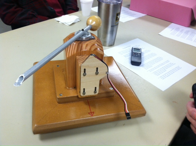

Bill's timing pylon was a heavy, impressive structure made of particle board with the timing platform and line pivot arm on top. It had two methods of timing, a micro switch tripped digital stop watch and a Hall effect sensor with a remote readout. The aluminum arm had a disk center with a spiral groove track on the bottom. There were two holes drilled into the track for the start of the second lap and end of the third lap. The track ended in a circle after the third lap hole. A whisker, attached to the micro switch rides in the track. The micro switch was tapped into the start/stop switch in the stop watch which was attached to the platform on the top of the pylon. You start the model with the whisker at the outside of the track. As the model flies around the pylon the arm rotates starting and stopping the watch when the whisker hits the holes. You have to go to the pylon to read the time, reset the watch and the whisker for the next flight. After a few test flights we realized that this Rube Goldberg electronic timer was just too touchy to work reliably.
The Hall Effect sensor, on the arm, was connected to a remote box with the electronics programmed to do the timing on the second and third lap and calculate the miles per hour at the push of a button. It also has a reset button and an on/off switch. This rig worked flawlessly except that the miles per hour calculation needs to be reprogrammed since it did not take into account the length of the arm. There was some concern about the drag of the massive (relatively) looking arm but it was not justified since the arm was on a bearing from a CD player and did not lag behind the line by the end of the first lap. In any event, since the mechanically tripped timer will be deleted there will be a much less massive arm on the pylon next week. The electronic timer pylon will definitely be used in the contest because with the regular pole and stop watches we discovered that with multiple people timing the spread between the times of a run were plus or minus 2 tenths of a second. We will still get another test session next Wednesday before the contest on the 16th.

Did some more testing at the O.F.F.C. meeting this morning. Bill Watson came in with two designs of his own and the new, improved timing head.
The arm on the head is still sitting on a bearing from a CD drive but it now, lighter, tubular and has a counter weight. A slight breath on it will start it spinning for about thirty seconds and it has no appreciable drag on the line. At one point Bill had a tiny TV camera on it transmitting pictures to his cell phone. This worked but the playback looked like the model was standing still and the room was spinning which was a bit dizzying. Richard Cox (president of the Conejo Valley Silent Fliers) who built the readout box re-programmed it so that the miles-per-hour read out worked correctly. This did require making the line nine feet four inches long to take into account the length of the arm. The original line was 10 feet long, including the paper clips, and pivoted on the nail in the center of the pole.

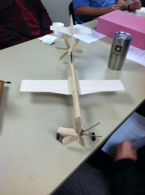

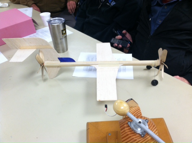

Bill brought two models, one very conventional and the other, well, take a look.
The push-pull propellers run off opposite ends of the same rubber band. When asked why he made six bladed props he replied, "I was going to make five bladed props but when I made the blades I had a couple more left so, why not?" He did get the fastest time of the day but it was only a marginally faster than my test hack. I was testing different propellers and found a very aggressively pitched Ikara prop in my stash that I thought would work well but it was only a tenth of a second faster than with a Guillow's five inch, red prop. I'm really thinking that the red prop is seriously underrated! My test hack seems to fly best on two loops of 1/8" flat. Four loops provides way too much torque although a couple of inches more wing span (current span 8 inches) might counter that.
