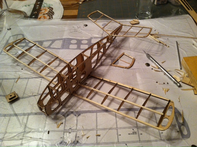

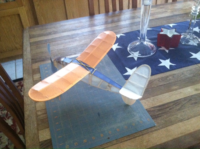

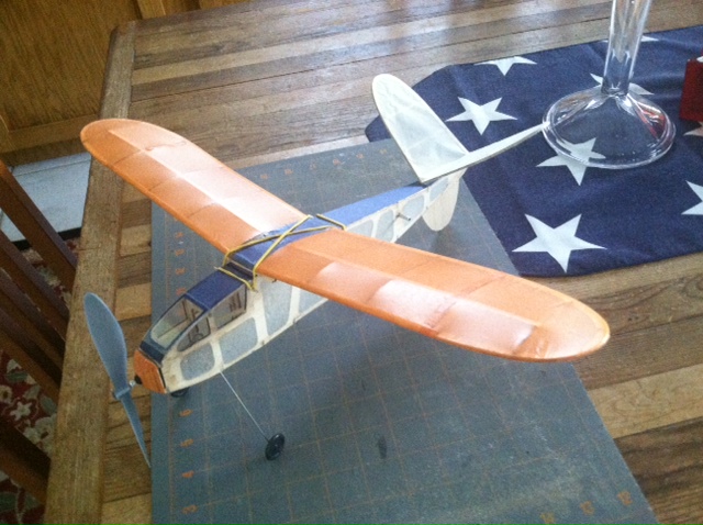

The OD-17, The Plain Plane, is turning out to be so successful that I've decided to join it with two more "beginner's models" in my line of kits. The next one is called the "Satellite". The first prototype is in flight testing. I want to get it, and the next one, a biplane called "Double Trouble" in production in time for Christmas shopping. My recovery from surgery took a little backslide but I am making progress again.

The Satellite is undergoing more development. The wing and tail surface outlines have been modified, and I have built a low wing version to test. If it flies as well, the production version will be produced. Just a matter of style.

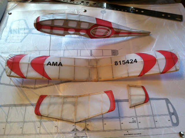

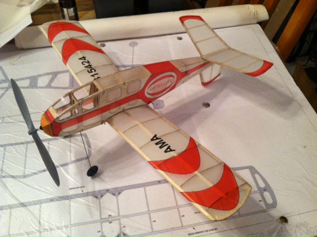

The low wing version is ready for flight testing. Having a little fun with the preprinted tissue. Nose block is the same one used on the high wing prototype. Turned out to need a little weight in the tail. The high wing prototype had a solid balsa under rudder. It weighs 24 grams all up with rubber and ballast. Did a 60 foot flight in the back yard which proved the trim. First serious flying tomorrow night at Luther. Will have to make decision which version to kit.

I took the low wing Satellite (along with several other models) to the Sepulveda Basin this morning for some tests while the FAC contest was going on. It flew but presented a few problems. It needed a degree more wing incidence, possibly slightly more dihedral, and I'm going to make another V tail to test it without the under rudder. By the end of the month I will know which one will be in kit.

I got it sorted out and it flies as well as the high wing version. There is one problem, however, with the under rudder the low wing version will not ROG. I've been told that V tails are not suitable for beginners, but I'm going to try the V tail again to get it to ROG. The issue is to make a warp free V tail that beginners can build. Back to the drawing board (computer).

I thought that I had a production prototype all sorted out but it did some strange things at the O.F.F.C. Predicted Time/Spot Landing contest last Wednesday. It flew fine in dead air but modest breezes discombobulated it. I had to put it on the balance rig and go back to the math to make sure that it was simple for anyone to trim. A few subtle changes (You probably would not see them in a photograph.) and now it's balancing with no ballast and flying outdoors nicely. I will check the indoor performance at the O.F.F.C. meeting tomorrow. If all goes well, I'll cut one more production level prototype and if it is trouble free this weekend I will have it available on my web site next week.
