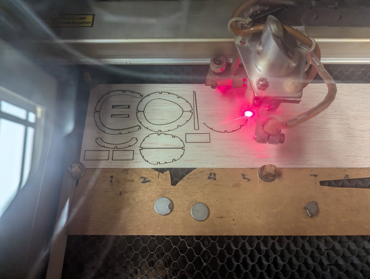

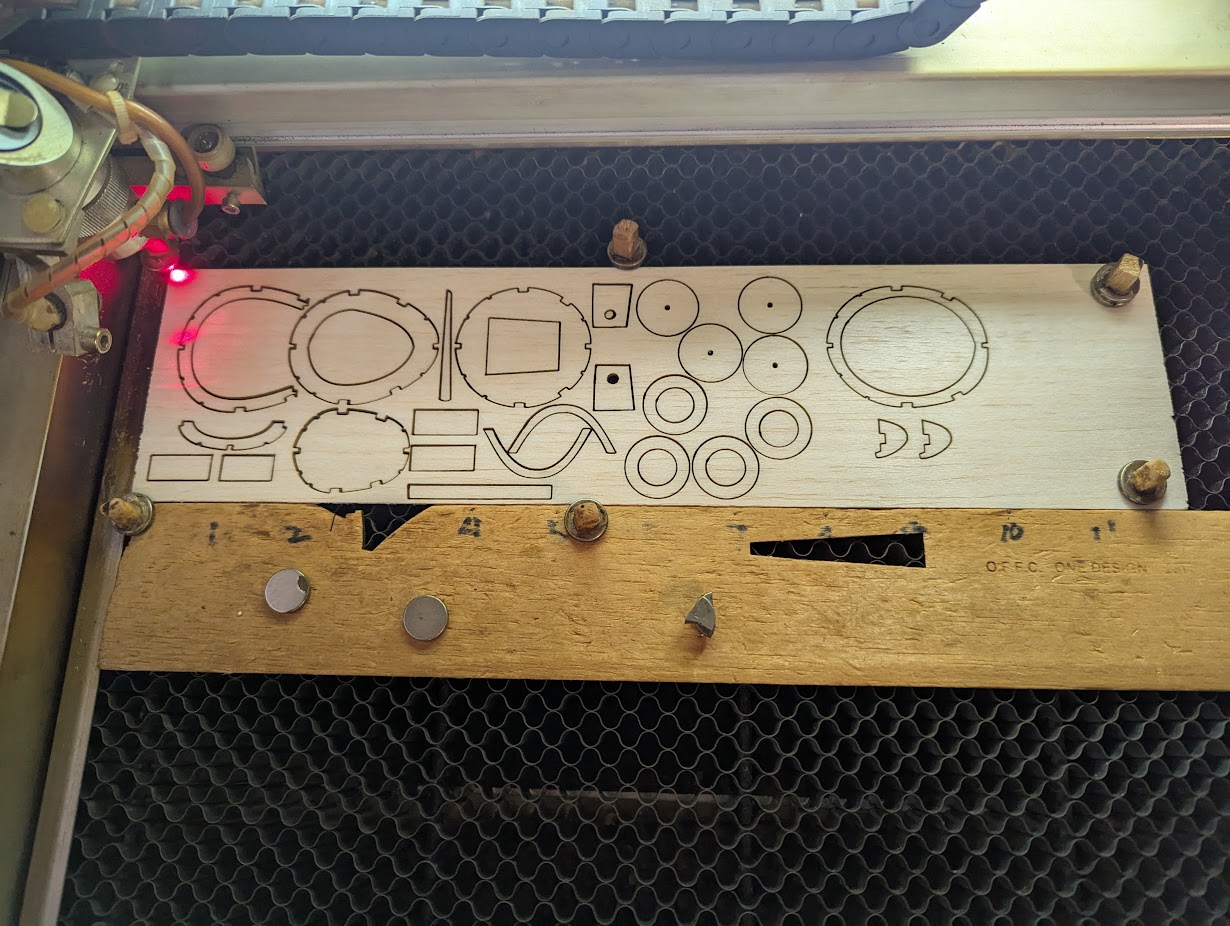

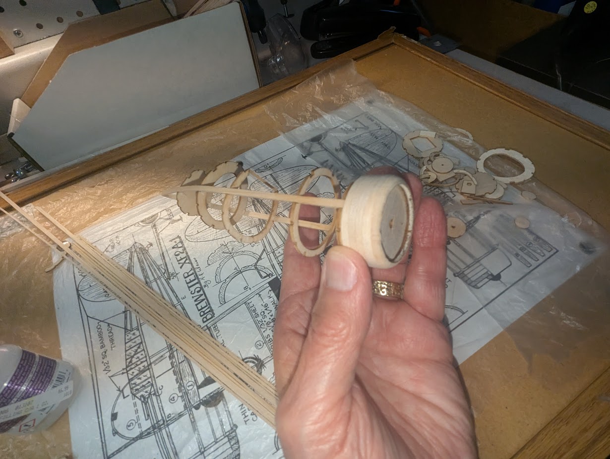

With a Peanut contest coming up I decided to build one of the Herb Weiss minute models as a Peanut. Now, why I thought this was going to be a good idea is beyond me currently. I chose the F2A, Brewster Buffalo, as the one to build. The first thing I found was that despite their small appearance and having "complete" plans on one page of a model magazine (More about the word "complete" later...these are 1930s plans.) they are somewhat larger. I scanned the plan into Inkscape, traced the parts and laser cut them.

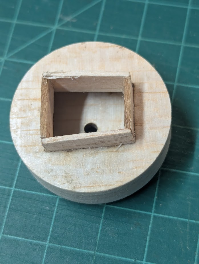

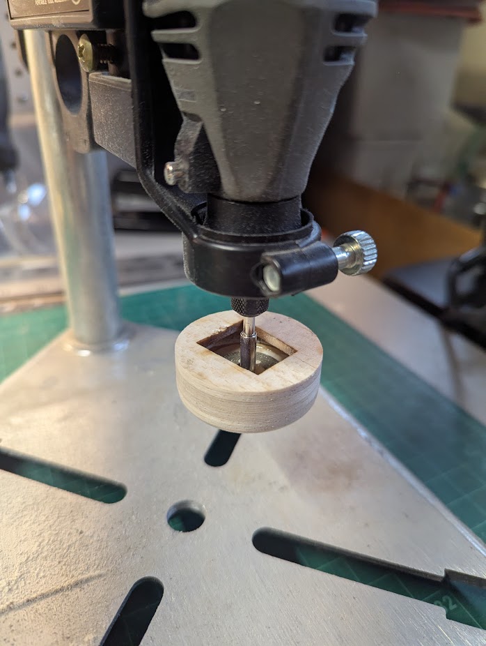

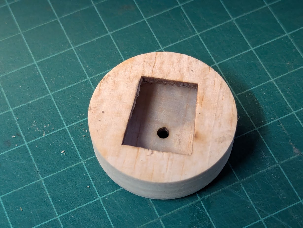

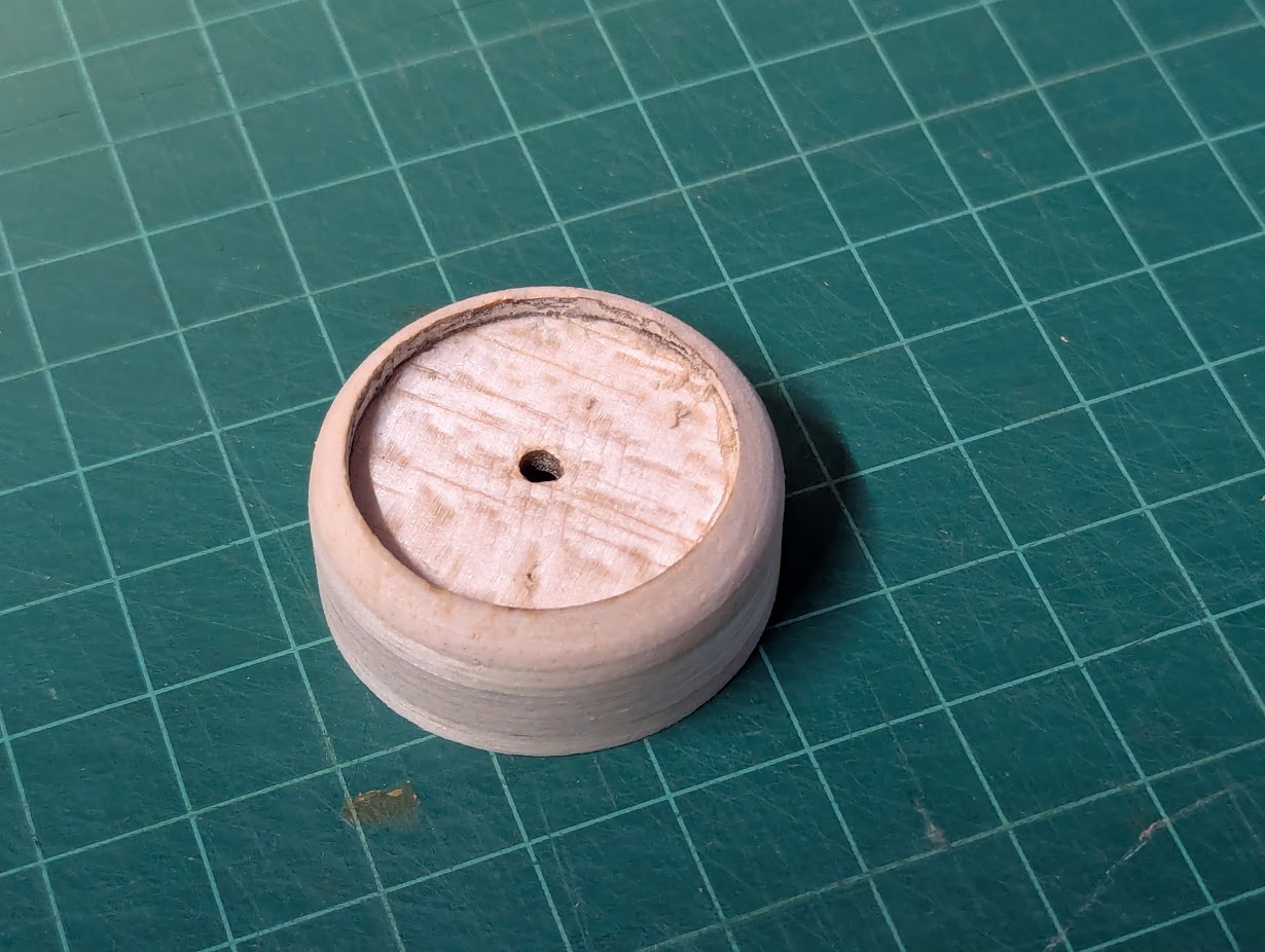

The easiest thing to start with was the cowl...it's round. Of course, I made one small modification, making the cowl removable for easy access to the rubber. I use trapezoidal keys whenever I can. I glued the cowl rings together, cross graining them, chucked the assembly in my Dremel drill press, and smoothed it out with a sanding block in a few seconds.

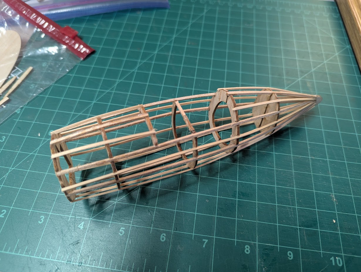

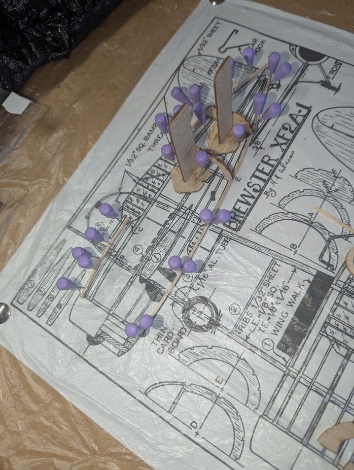

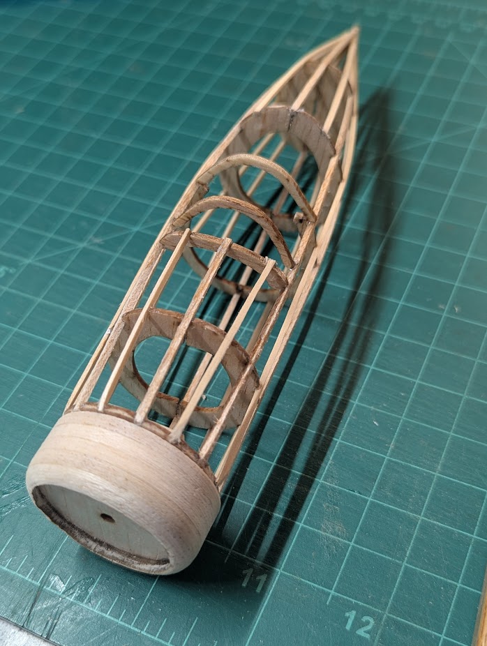

As you saw in my last post I changed the design to half former construction and cut new parts. I pinned down a top and bottom keel of 1/16" square. Then I pinned down right angle tools to the plan at the former positions. Working from back to front (to keep from trapping a right angle tool in the back of the fuselage) I glued in the half formers using the right angle tools to keep them perpendicular to the building board. I changed the 1/8" X 1/16" crutch to a 1/16" square side keel. I added the side keel, carefully then removed the last right angle tool. Herb had a 1/8" X1/16" master stringer that defined the edge of the cockpit and I changed that to 1/16" square also.
Now to get to get the other half on. This is where flat craft sticks and small clamps come in. For a model this small I split some craft sticks in half lengthwise. I apply a stick to one of the formers already glued on with a clamp, then put the other half of the former in place, clamping it to the craft stick, check the alignment, and apply glue. This technique works with any keel and half former model that doesn't have self jigging interlocking parts.
With the other side keel on I'm not building a banana and all I had to do was put the 1/32" stringers on. I built the key on the back of the cowl and checked the fit.
