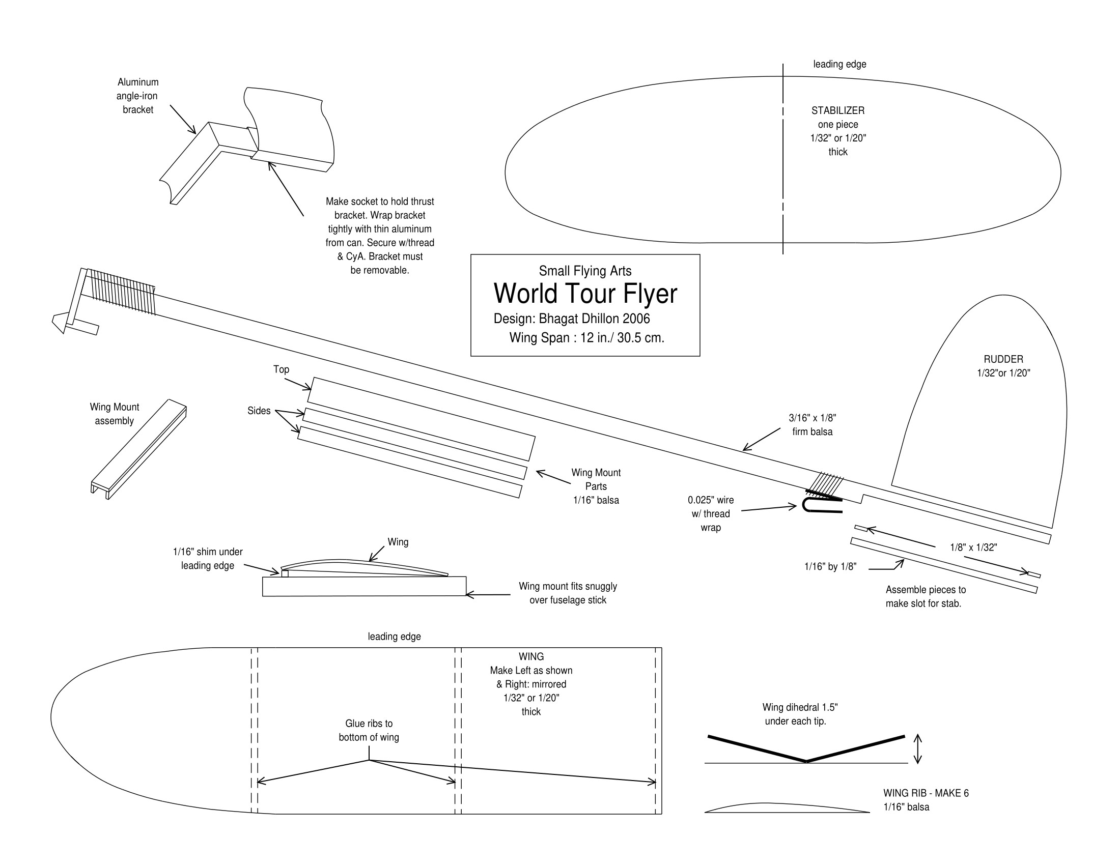

A cleaned up version of the World Tour Flyer plan
Post by Balsa-naut »
Attached is a cleaned up version of the original plans for replicating Sophia. I'm just an average builder, but my build flies pretty well using the 3/32" rubber motor. For simplicity, I glued the bracket and stabilizer directly to the fuselage stick. The original plan and building guide can be found here https://smallflyingarts.net/worldtour/wt_flyer.htm
