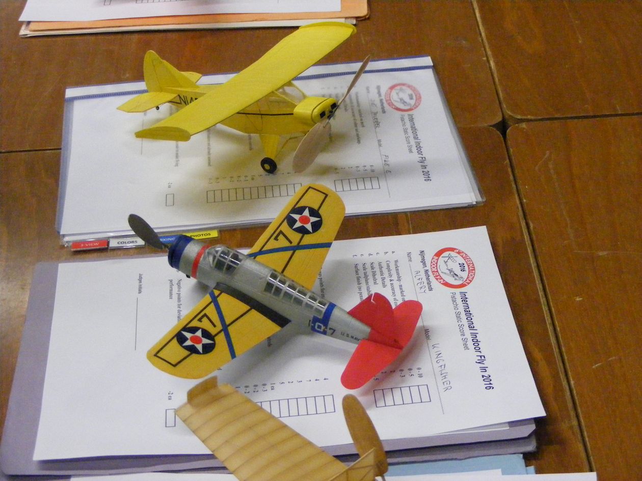

Alfery "Kingfisher"
Alfery "Kingfisher"

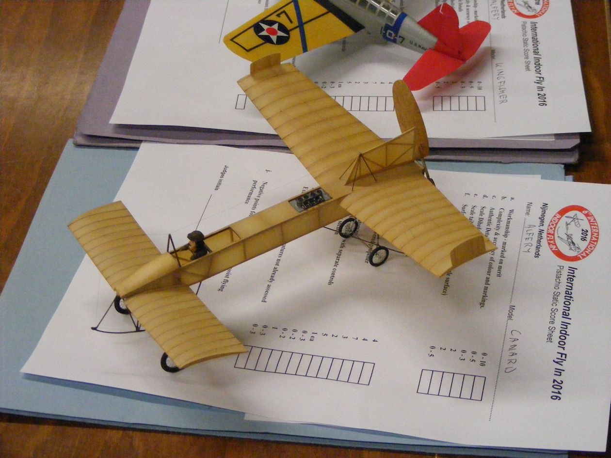

Alfery "Canard"
Alfery "Canard"

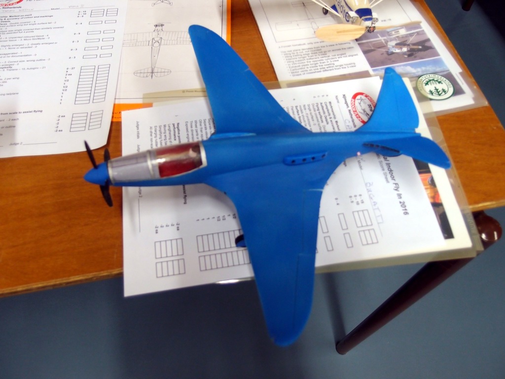

Another exponent of foam models was Jacques Cartigny, whose Bugatti made very realistic flights using almost the entire space of the hall, looking just like the racer it was meant to be.

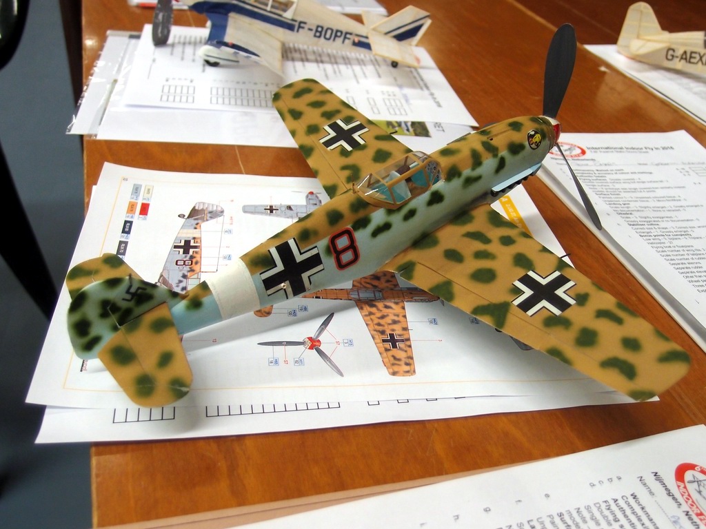

This Messerschmitt 109 is another of Jacques models. Note that it does not have the thin undercambered type of wing profile usually used on foam models, but a scalish profile where even the wheel wells have been cut out!

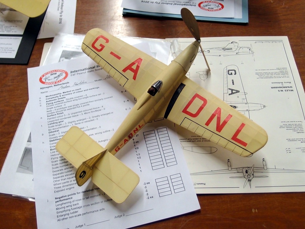

Here are some more photos. First my own Miles Sparrowhawk, built from the Mooney plan but with many modifications to improve scale fidelity. Among these modifications were two that I regret; scale sized stabiliser and reduced dihedral. With the scale stabiliser the model proved unstable even with CG at 1/4 chord, replacement with a Mooney sized stabiliser solved that problem. The dihedral is unfortunately more difficult to change... It has flown 30 seconds outdoors, but at Nijmegen it showed no inclination to fly and broke the propeller.
It's built in the traditional way, painted tissue covering with registration letters cut out from paper.
