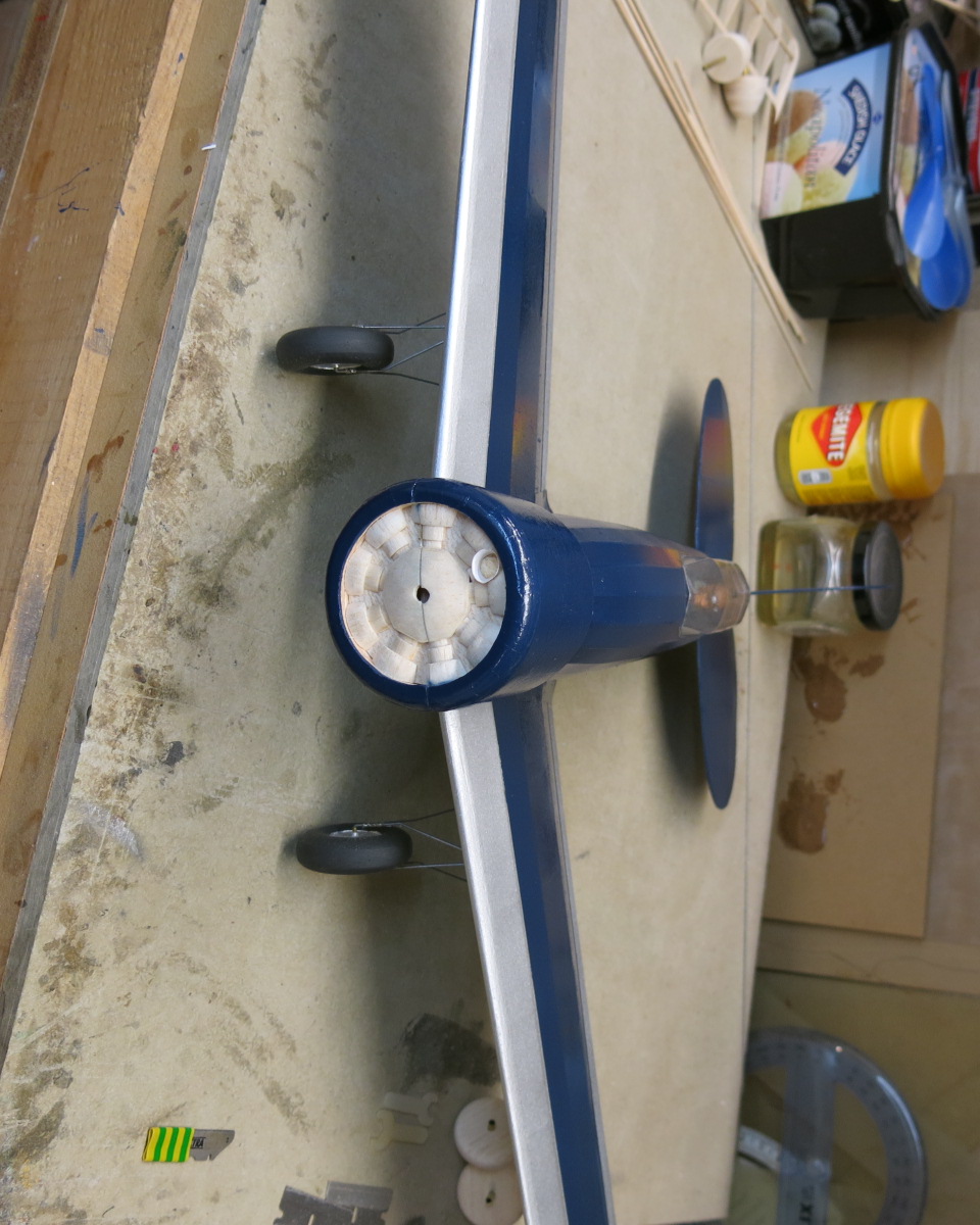

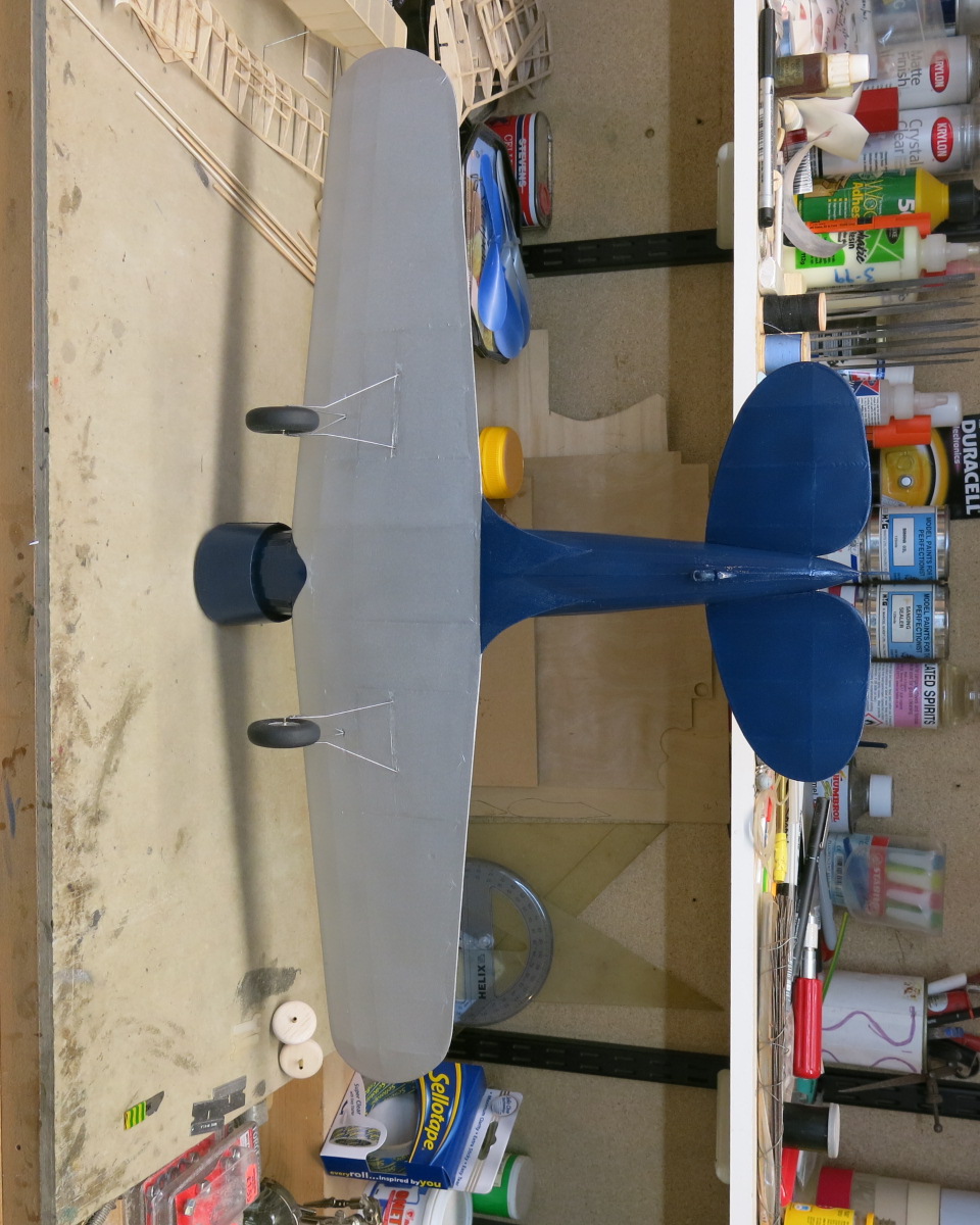

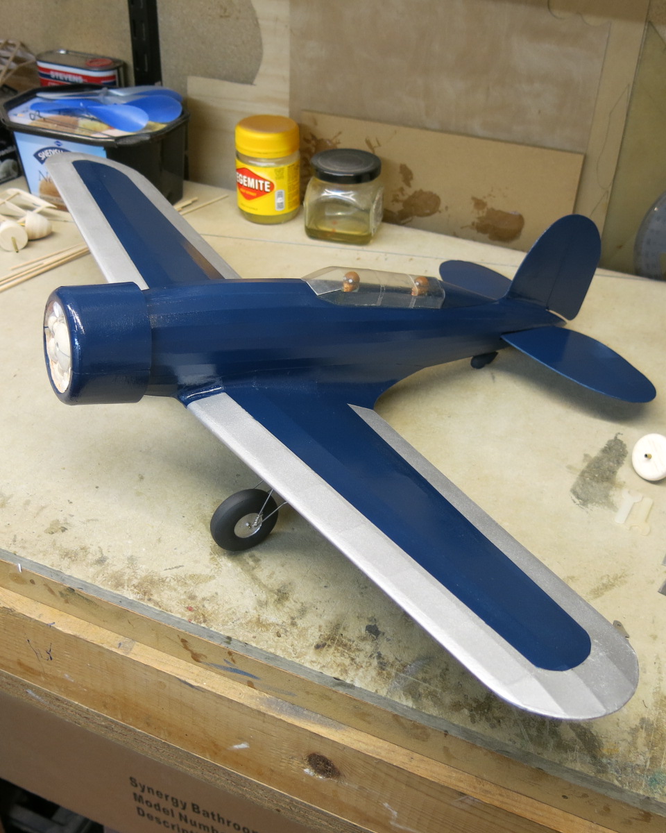

Even glaciers move downhill and the glacial progress of this build has taken a lurch towards the end point. A fairly big lurch actually as you can see. Not much needs to be said other than "It's been painted!".
Some pics
Some pics
- IMG_1585.JPG (298.61 KiB) Viewed 26646 times
- IMG_1584.JPG (327.86 KiB) Viewed 26646 times
- IMG_1586.JPG (304.22 KiB) Viewed 26646 times

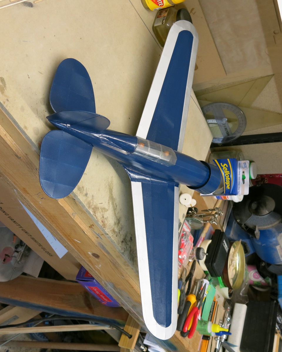

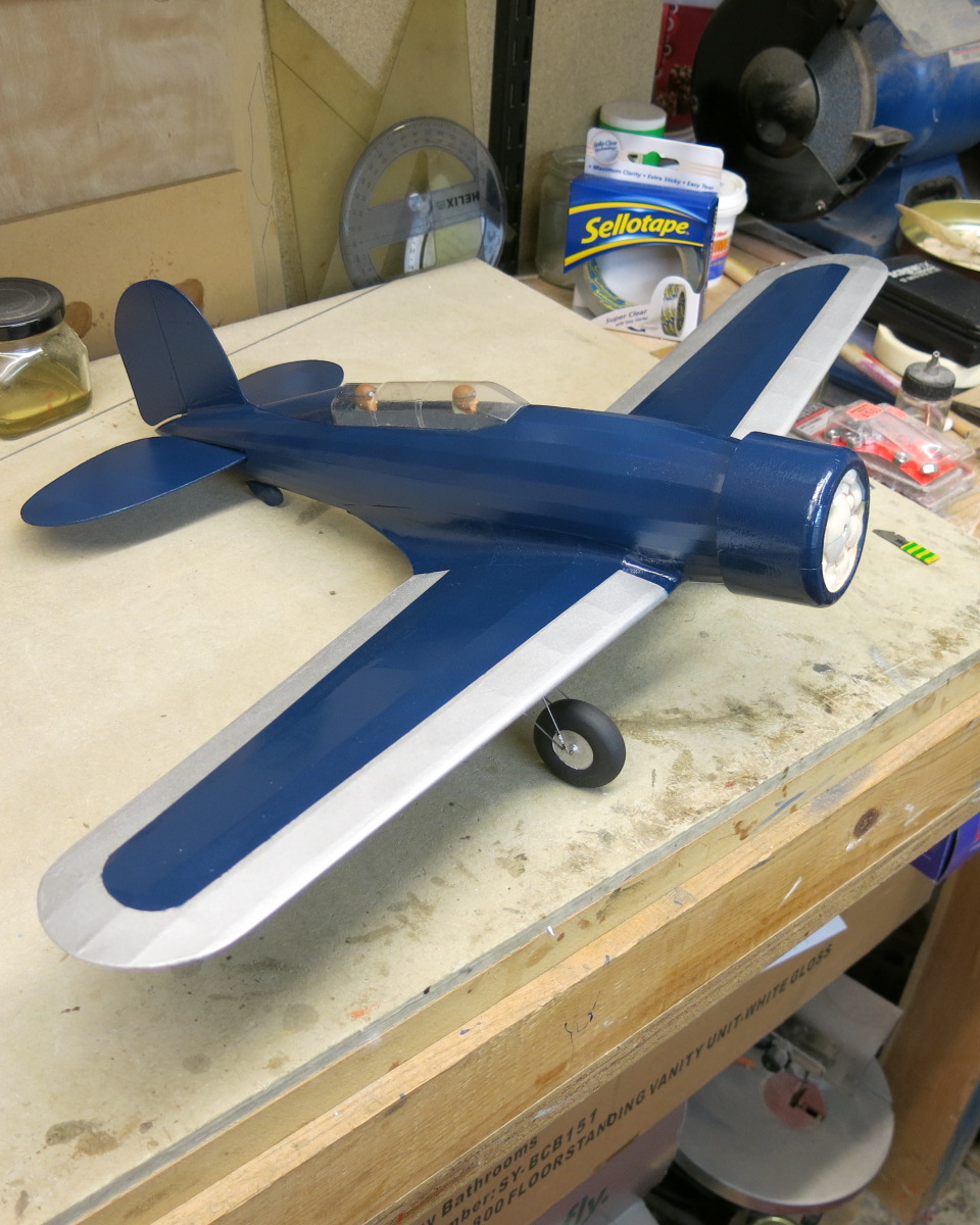

Re: Lockheed Altair
more
- IMG_1587.JPG (334.09 KiB) Viewed 26645 times
- IMG_1588.JPG (320.17 KiB) Viewed 26645 times

It's looking magnificent, Tim. This is going to be a stunning model!

Tim, she looks very good in the opaque dress
I am always afraid that I will tear the colour away when I remove the masking tape. But it seems that you did not have the same problems...
Maybe the different colour made the trick... I have to check this in the future.

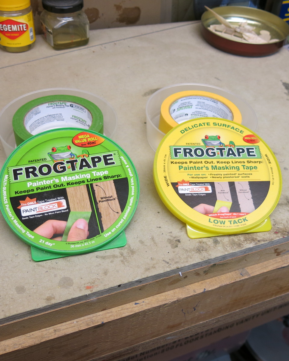

Thanks Roman, thanks George.
For masking I use an ordinary painters masking tape called Frog tape. It is available in most builders merchants and DIY stores here. They do a few different types. The ones I use are the standard (green) and the low tack (yellow). I stick the tape to a piece of paper so that only 3mm to 6mm of the tape edge is left so there is less to remove. Also I run a bead of dope around the edge to seal it better to stop the bleed under the edge. It never fully succeeds but is better than just the tape on its own. It also depends what you are sticking it to; doped tissue is good and so is gloss paint so you can leave less edge of tape. It won't stick so well to matt paint so I leave a wider edge of tape, and silver paint is the worst, sometimes the tape won't stay stuck down to it at all!
I also use it for canopy framing. Just stick a length to my cutting board, paint it and then when it's dry cut strips of the width I want and stick them on. It sticks quite well to acetate.
I agree with George about removing it; very slowly at 180 degree.
I am not planning on finishing it for the UK Nats. After all this time it would be unwise to rush it and I have not had anywhere to do any trimming this winter thanks to our inability to use the Velodrome. I hope to do some outdoor trimming with it once the grass grows and Roman sends us some of his Swiss weather
. Then if it flies and I manage not to wreck it, we will fly it in Nijmegen.
This is the Frog tape.
- IMG_1589.JPG (364.82 KiB) Viewed 26585 times
