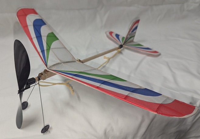

The model in the photo is a laser cut version of Wade Wiley's Basin Flyer. The Basin Flyer is a good performing, simplified model.
Laser cut prototype.
The kit will be available at the end of August.
