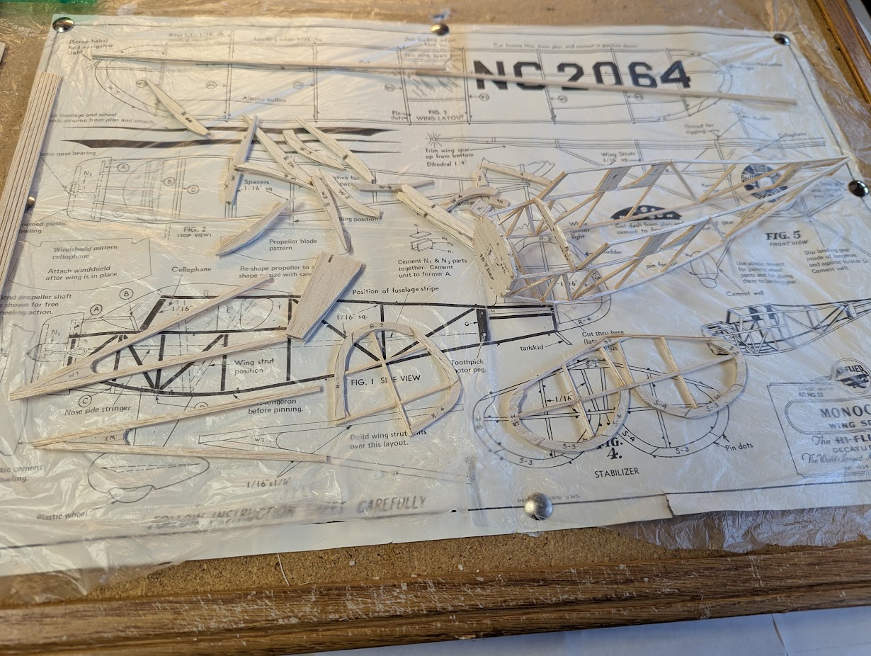

Cold, dark and snowing outside. What to do? Make a prop!
- Posts: 254

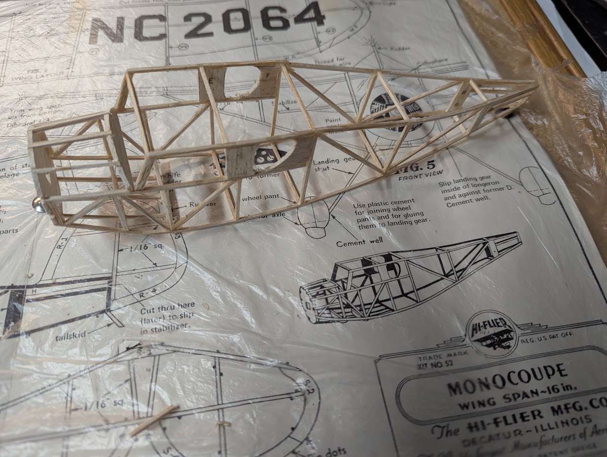

There is a dime scale contest coming up at the end of the month. Dimers are usually not my thing but I have the kit so why not? I used the original parts sheet but the next time I do one of these old kits I may scan the parts sheet and laser cut for accuracy. This is really one of the better dimers of the period but there are still two gross errors in the plan, both in the construction of the wing where the realities of tapering the spar and joining it at the dihedral joints have been ignored. I know the kit was prototyped because I have seen pictures of it but the problems with building the wing were probably not communicated back to the person that drew the plans. (Not that I have not made errors in my own kits.)
That little box fuselage was probably very frustrating to inexperienced new builders back in the 30s if they didn't have someone to guide them. Although I had been building flying models with my father since I was seven the models I built by myself were all sheet until I was thirteen, Comet Struct-o-Speeds, Airline models, Monogram, Cleveland (yes, they had an all sheet line in the late 40s and early 50s.) and Top Flite to name a few. One of my relatives gave me a Comet P-38 kit for my eighth birthday but I didn't attempt it until I was fourteen. (If you haven't seen one, Google the plan.)
